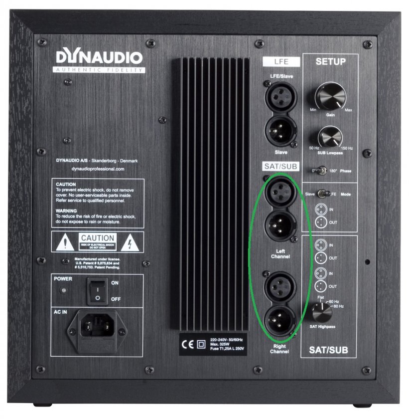

But I don't see how the Dynaudio Bookshelf speakers can feed any sub, Dynaudio or otherwise, with a signal. I don't see an output jack of any kind on the Dynaudios. I could be very dense, though.
I think you will need to use a sub that has line-level inputs and main/sat outputs.  You connect your source or preamp directly to the subwoofer inputs, then feed your BM5s from the subwoofer outputs.
Here is a Dynaudio BM9S II sub with XLR in and out.  There is a high pass filter for the sats in case they don't already have built-in high pass filters like the BM5 mkIIII.
Steve

OK then, lets focus on just the Dynaudio BM5 MkIII's (Dyn's).  You're right, the Dyn's cannot output to anything.  Audio signal would go from a source to a preamp (or integrated amp line output) to the subwoofer (sub) and the Dyn's in one of two ways:
1.) Connecting left and right outputs to the sub and connecting left output to the left Dyn and connecting the right output to the right Dyn.  This is easy if you have two pair (left/right) low level (RCA/XLR) outputs.  If not you'll have to use a splitter as mentioned above.
2.) With the right sub, just connect left/right low level outputs from the preamp (or integrated amp line output) to the sub and connect left/right low level outputs from the sub to the left/right Dyn's.  The Dynaudio sub shown by Steve is one of the right subs.
