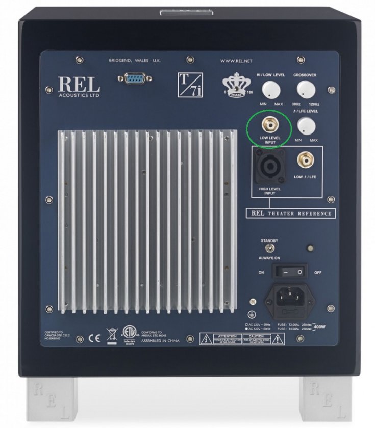

The Rel has either a Neutrix speak-on or a full range sub imput, no RCA?   Hence my quandary.  :oops:

The REL T7i does have an RCA  low-level line input, however it is a mono input and it may not be a good idea to try and combine the IDA-8 stereo sub outputs to mono with a simple Y-adapter.
You should never combine signals with a Y-adapter. Those adapters are typically meant for splitting outputs, not combining which could potentially damage the output stage.
That said, in the sub range most frequencies tend to be in mono already so you can simply try just feeding one channel in. There's no harm in it.

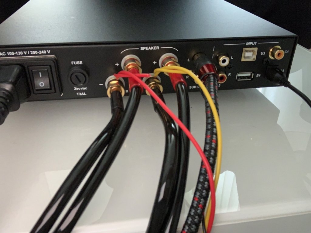

I'm using high level input with REL T/7i and IDA-8
Speakon cable is connected to - not + amp outputs
REL sent me info on connection method via email
https://relsupport.zendesk.com/hc/en-us/articles/115004486607-Class-D-Amp-Connection-Methods

« Reply #12 on: 10 Jun 2020, 01:44 pm »
I'm also using high level input with B&W ASW 608 Sub and IDA-8. Its work much better than low level connect (the subwoofer is quiet and better paired with the satellites)
