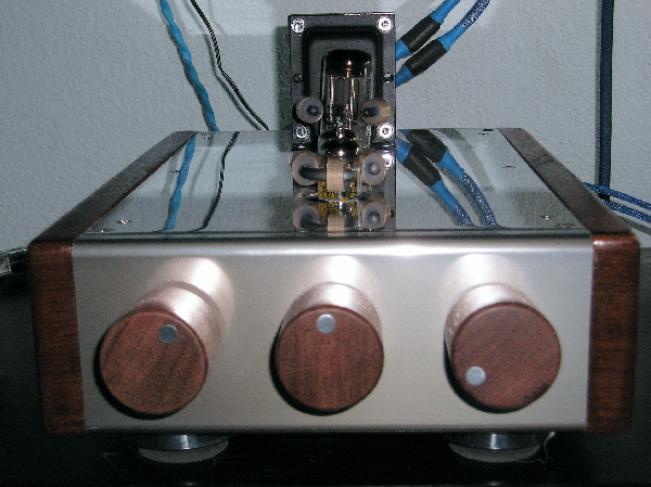

Congrats DeadFish!!
Where are the pictures?
I just "upgraded" my Clarinet.
I had some smaller Cocobolo knobs on the front. I changed them to BIG Bubinga knobs to match the side panels.

Deadfish I'm glad you brought this up!  I've been wondering about this for a while now, but I hadn't taken time to take things apart and try to debug it, or post a question here.  Anyway, like Wayne said, let's see some pics and hear more details about your Clarinet!

Thanks for the encouragements, folks!
First off, got 4 pictures in the Gallery
http://www.audiocircle.com/index.php?action=gallery;area=browse;album=424

P.S. Yeah, yeah, if you looked at the pictures, I know.  I gotta get some black screws for the top of that thing, real soon!  :D

Looks great DeadFish!
