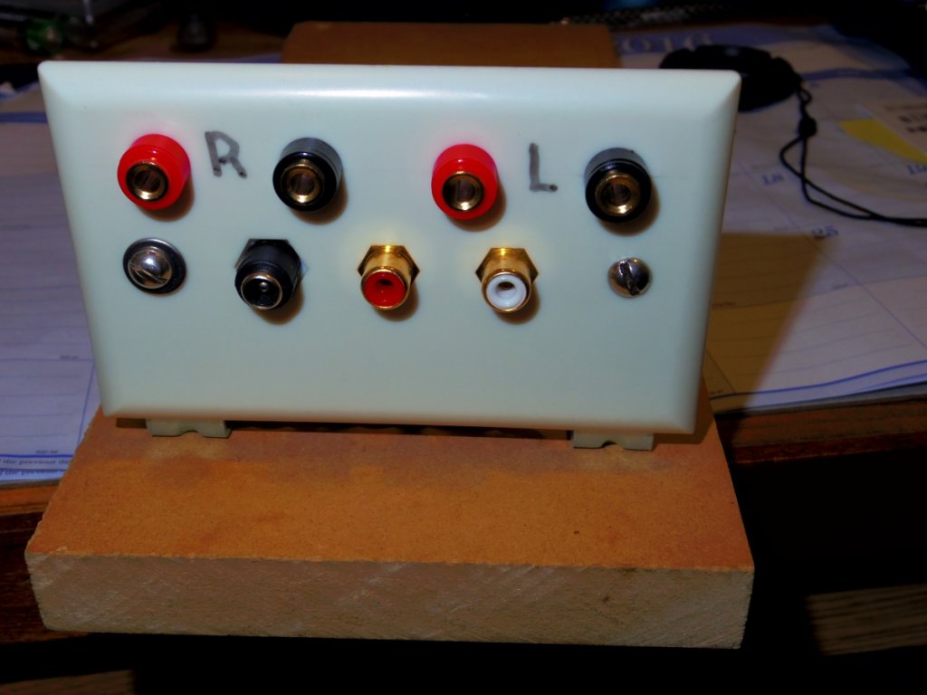

I too feel you should consider getting one of the inexpensive Class D (TPA3110/3116/3118) or chip amp (TDA7297) boards, and mount it on a piece of wood. The "Volt" amp Odal3 suggested would be a good choice.  Here's one I recently set-up for evaluation. I will eventually be installing this one in a nice case, but it's totally functional as is. This particular board is the DIY Audio group buy "Wiener" amp using the TDA 3118 chip, with quality parts throughout. It can be powered by a 12-24V power supply such as a laptop brick. It sounds fantastic!
 You don't need to be a hard core DIY'er to build one of these. Here I am using cheap solder type connectors for input, power, and output, but you could use RCA, power jack, and speaker posts that do no require soldering. Most of these amp boards have screw down input/output connections so you could assemble one of these with just a screwdriver in 15 minutes.
