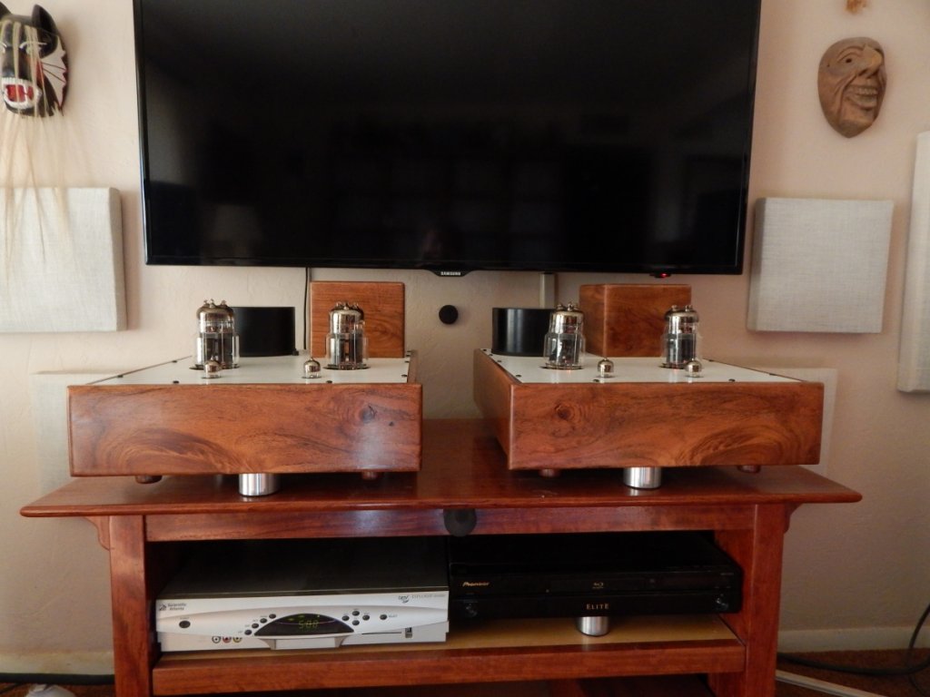

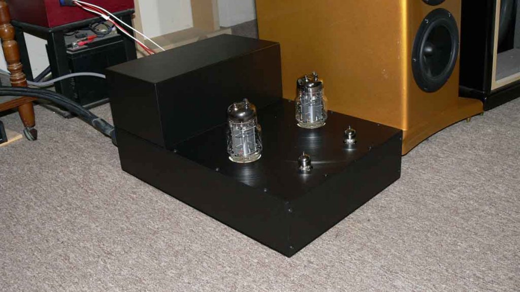

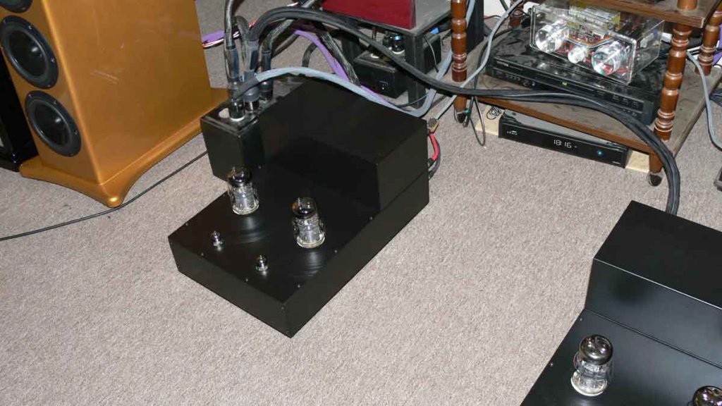

My buddy  finally took delivery of his   "one off"  ( 4 pairs in existece) k&K 6C33C P/P monos today and being he's speakerless at the moment,  they are  playing n  my room :)
These use  2 6J49P input tube and  2  6C33C output tubes per  amp.  Power, ,output, and interstage Lundalhl transformers. Each  amp is about  70 lbs, they are   beauties.  Best of all, they  just sound amazing.... HUGe sound stage and extremely rich with  a  ton of depth.    Been listening for a  few hours   and    I'm  just wowed  .  Very nicely done   Kevin (K&K Audio)

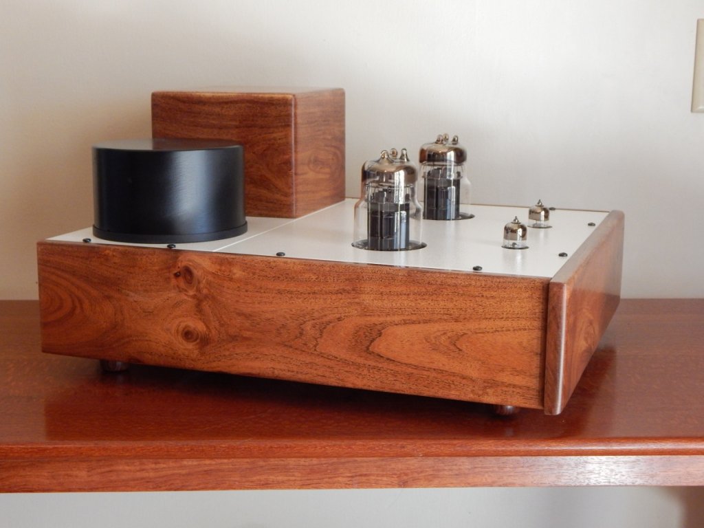

A few pictures to share of my version of the 6C33C PSE amps from K&K. My amps are slightly larger than the chassis that Kevin uses. Powder coating was done by a local paint shop. Power transformer is potted with a marine grade epoxy. Wood on the sides of the amps  are re-sawn and book ended to match on each amp. The front plates as you can see are book ended as well. Hook up wire for the power supply is 20 ga. fine silver and signal wire is 22 ga. fine silver. Components are mounted on a mid -plate that allows access to top and bottom of the circuit boards.

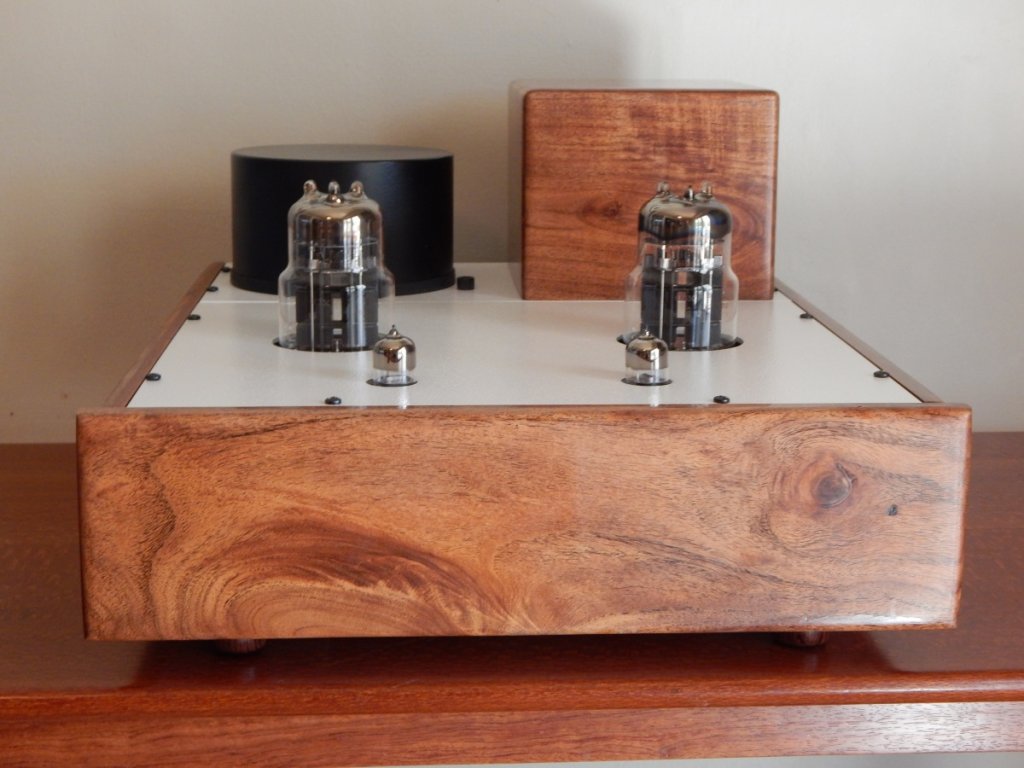

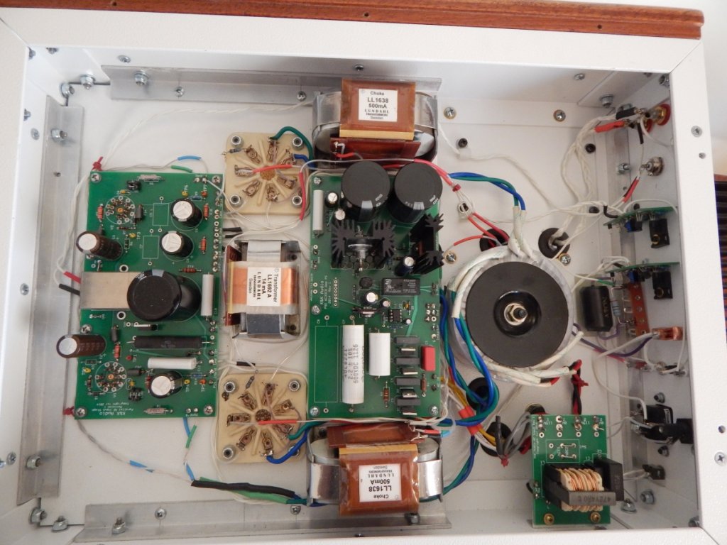

I thought I would share another one of Kevin's excellent designs with the group. This is one of his KT-120 based, push-pull Class A1 monoblock amplifiers I recently completed. I mounted the Lundahl output transformer and choke externally in Lundahl housings. The main power transformer is a custom toroid designed by Toroidy http://sklep.toroidy.pl/.  Separate filament transformers are located inside the chassis.  I will let Kevin chime in on the operating details and design. In a nutshell, I am thrilled with the sound of these amps. Since I live in the RTP area, I was fortunately able to audition the KT-120 and 6C33C amps at Kevin's shop on his system.  Both of these amps sound wonderful, and really boils down to ones personal preference and your output power requirement. At approximately 20 watts rms, they easily drive my current 87 dB efficiency speakers to adequate listening levels for my taste.  Yes, in a few cases I have found some tracks recorded at lower levels, requiring full volume on the preamp. Soon I will be building the same NX-Otticas Jay previously mentioned which are much more efficient and will giver me the desired headroom with the amps.  A word of warning: Once you start building Kevin's audio equipment, it is hard to stop. Next up for me is Kevin's single-ended line stage preamp "Mir" http://www.audiocircle.com/index.php?topic=146892.0.  I have one of the prototypes running in my system now and it's a definite keeper.
