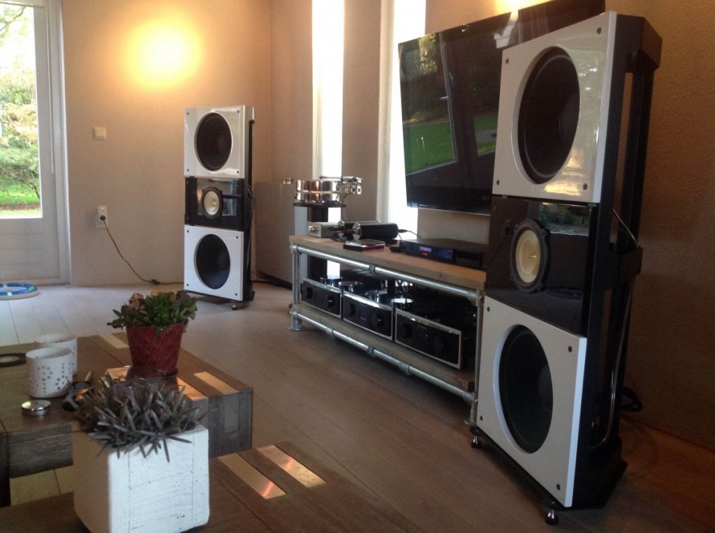

I've been breaking in the TB 1808-8.......very nice, but I know I'm going to end up with the Vox..... :wink:
Anyway......here goes.
Ordered up some 3/16" flat stock, drilled the pilot holes and cut them to length....
I decided to go a bit different than PAP connection to baffles. They use baffle to wood, I used a 1/8" breakshape
that I had made up......1'x 2"x 1-1/2"
I bolted the frames together, making sure that everything was true and square....
For the back spine I used wood.....could of used another breakshape, but I thought the wood would soften the
lines a bit and make it a bit less industrial looking.....
Heres a pic of the baffles being dry fastened to the breakshape.....
This is what they looked like assembled....
Took the baffles off to paint. The frames came out nice....
I used the hammered/texture type......I like the look of it...
Gave the baffles a shot of primer today....
I've decided to go with a raspberry/burgandy for the center baffles and black for the upper and lowers.
I'll continue on when I start the baffle painting.....
Thanks for looking.
