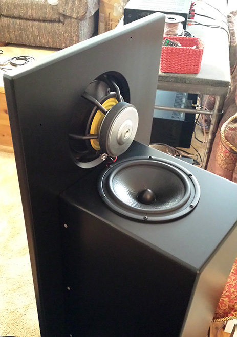

  From a Home Theater Review review:
  To explain his design theory and the implementation of his strategy, Alexander states, "My open-baffle hybrid concept is easily visualized as the following...place and locate a speaker on a flat panel--a pure open-baffle dipole producing sound on both sides of the panel in equal and opposite pressure and polarities. Next, place a second speaker matching in size on the rear side of the open baffle, locate it within immediate proximity to the open-baffle speaker, and use it to create a short circuit nullification path for all low-frequency content radiating from the back side of the open-baffle speaker. Wire the open-baffle speaker and the nullifying speaker in tandem, so they are moving in the same direction to create an acoustical mass transformer. This process produces a monopole low-frequency radiation pattern that entirely emanates from the front panel, then smoothly transitions into an open-baffle dipole radiation pattern, the attribute of open-baffle/planar design that makes audiophiles drool, from the mid-bass frequencies going up. The standard (classical) embodiment of the invention/design is to dissipate the rear energy produced by the nullification (short circuit) speaker using a secondary enclosure of the infinite baffle or transmission line with long termination. Product development phases proved it was advantageous to incorporate a venting system that increased system efficiency and further extended low-frequency performance."
  So what does this do, in simple terms?  Or is this just an example of salesmanship hyperbole & technobabble?  (Which is not to say they don't sound good.)

Sounds like dipole for higher frequencies and bipole for the lower frequencies.
But what does "wiring in tandem" and "acoustical mass transformer" mean?
Infinite baffle can only practically be done via wall mounting, which can't be a bipole (but transmission line is mentioned).

In tandem = in phase; dipole radiation out of phase with ported box driver.
Infinite baffle = sealed box.

So push pull isobaric but on OB?  Don't get it.
I have absolutely enjoyed OB bass in the past too.  But just a simple implementation.
opnly bafld
Re: Tekton OB Sigma Design--What?
« Reply #6 on: 18 Oct 2016, 09:46 pm »
Ported driver firing up in back.

I dare say the frequency response would be rather lumpy around the low end and rather odd with just the front firing ports supporting the open baffle section.

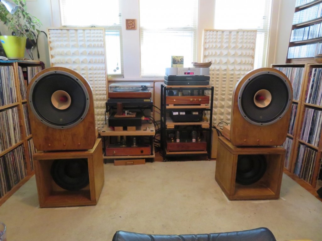

Hello to all! I know it has been a while since this topic was commented on but I'm a Tekton OB Sigma owner and I'd like to add a 1st hand report on the  speaker:
A little background: I have spent more than 17 yrs enjoying a pair of Apogee Duetta Signatures and I am very familiar with dipoles/open baffles and the concerns of how to get them to perform at their best. As most of you know dipoles have an especially appealing "airiness" or "spaciousness" about their presentation but their designers do have to contend with the bass cancellation issue which, of course, various manufacturers have done with varying degrees of success. I dealt with my Apogee's ultimate lack of low end by carefully blending in a pair of Hsu Research subwoofers and I managed to achieve a quite satisfactory measured and subjective balance in the 2 different listening rooms in which they were used. Both were rather sizable allowing for over 7 feet of space to the rear wall and over 4 feet to the side walls in the 1st room. The 2nd room had dormer openings left and right that were 5 ft deep half way down the side walls on both sides. The speakers were placed at the leading edge of the dormers from the back wall and eliminated what early side reflections there are with dipoles and worked as a diffuser offering the best sound I'd ever had. These speakers did have to go back to the factory in MA twice over the years to have the panels tensioned and the second time they actually replaced the bass panels with an "updated" version less prone to the tensioning issue (so I was told, but that was the last time I had the issue before I sold them).
After a few years with a selection of stand mounted monitors from B&W and Spica (incredible sound stage from these old favorites!) and the Hsu subs. I began to miss the dipole magic and began looking around again for what was available. I was aware of Maggies of course but had found their sound "constrained" for the kind of dynamic music I most enjoy. Then I started reading about this guy in Utah and his Pendragon and Enzo speakers and how popular they'd become for their price. When I looked at his website I saw the reference to his OB Sigma and his brief description. Now, you can poo-poo his comments if you like but the idea of cancellation of low end behind a baffle of sufficient width fading carefully into the upper bass/lower dipole midrange made a great deal of sense to me. Shortly thereafter he offered these speakers at nearly half price with a 30-day return policy. With no risk I ordered a pair to see what it was all about.
I've been playing with these for nearly a month now. They work rather spectacularly IMHO, but their are a few issues I'm looking into dealing with. Walking behind them as they play is revealing...the "initial" bass is gone in the near field. As I pass into my bedroom behind and across a stairwell away it returns as carryover from front firing bass no longer cancelled wafts into the house. The fairly wide baffle (17") does tend to focus the tweeter's output to a fairly narrow sweet spot and, though the baffle edges are rounded, I suspect diffraction off the edge a bit. A little playing around with some F11 wool felt strips should ameliorate that issue and, in black and carefully cut, I should be able to retain the speakers stark but appealing "industrial" simplicity. I really don't give a damn what they look like as they're in a room dedicated to only music and usually totally blacked out ;-) I'm keeping these for sure as they have again returned to me that wonderful dipole airiness, solid slam factor that dynamic drivers do so well (excellent Seas drivers) and SOLID bass performance. Like all speakers I've ever owned they do benefit from a little careful room treatment - bass traps, diffusers, and absorption panels here and there.

This is going to produce a cardioid-shaped bass response: https://www.google.com/search?q=cardioid&ie=utf-8&oe=utf-8
It's not a new concept and most recently the Kii Three speakers also employ a rear-firing bass driver that is meant to cancel instead of add, so it also produces a cardioid-shaped bass response.
IMO, it's an overly-complicated solution to a non-existent problem. It's not like cardioid bass is going to eliminate bass nodes under the Schroder frequency...
