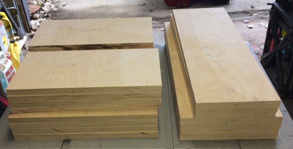

New project. A pair of X-CS Encore cabinets which will be used as main speakers. These are being built out of Baltic Birch, all edges rounded over and finished with DuraTex.
First step is completed, all the parts are cut out.

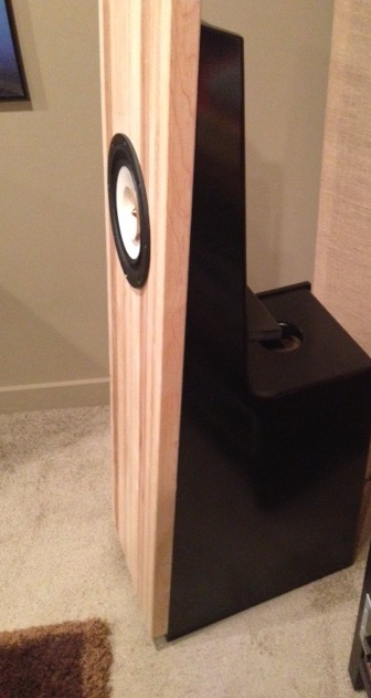

I really like Russian BB and Dura Tech, but... Stain these please....  tell him you can not cover them in black goooooo
BB stained
BB Stained
Side is Dura Tech

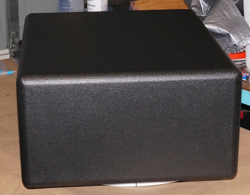

The NoRez is already installed. They are almost finished. I have been having a little difficulty getting the desired finish for the DuraTex. Normally DuraTex is applied with enough texture that seams don't don't need any special prep to keep them from showing. However, I am rolling the texture much flatter than normal and this has been causing some issues with seams showing
I decided to treat it similar to paint and sand between coats. I used 320grit to sand off the high points and flatten out around the seams. This appears to be working. No pics yet though because I'm not done.

If you let it dry just a little and keep going over it with the roller very lightly then you can get a very lightly textured pattern.
I also recently did the same but instead of re-hitting it with the roller I patted down with a wadded up plastic bag. It looks almost like leather.
mlundy57
  • Posts: 3643
Re: X-CS Encore build - as L&R Mains
« Reply #15 on: 10 Nov 2016, 04:15 pm »
That's about what I've been doing, lightly rolling over it about four times in different directions and when rolling over an edge, not stopping just over the edge but continuing down the adjacent side, pulling the roller away at different places. Then I smooth out that adjacent side.
Once the DuraTex has dried I move on to the next side. I lightly sand the side I'm getting ready to coat with 320 grit to make sure I don't have any high spots or ridges, then roll on the DuraTex with the sponge roller that comes with the kit. Once the side is coated I repeat the rolling down process.
Let dry then repeat on another side.
The texture is muted but still rough to the touch, not smooth like leather.

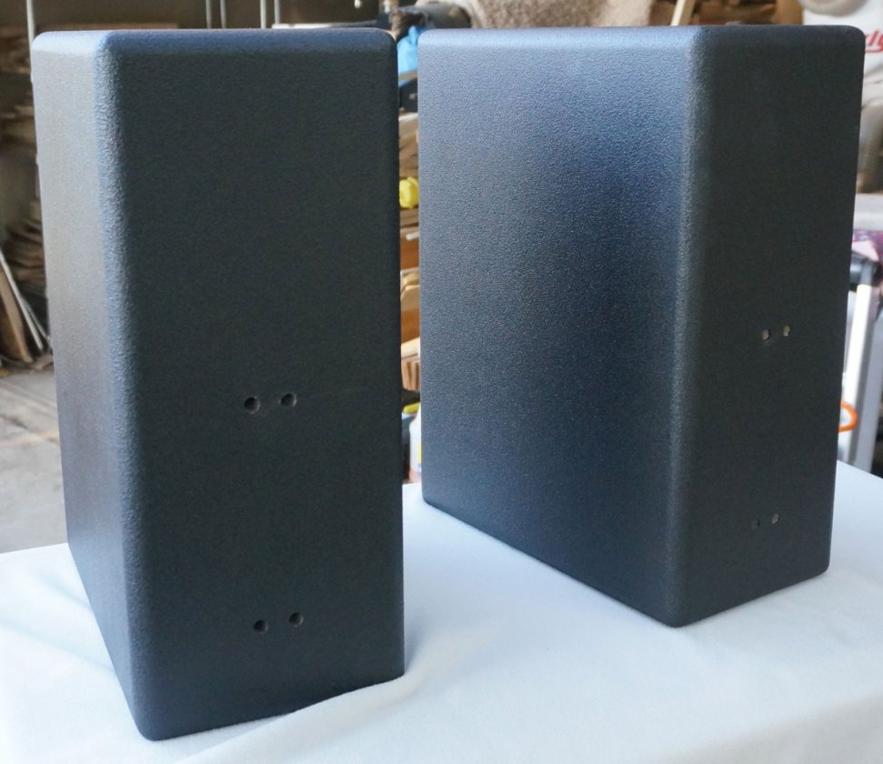

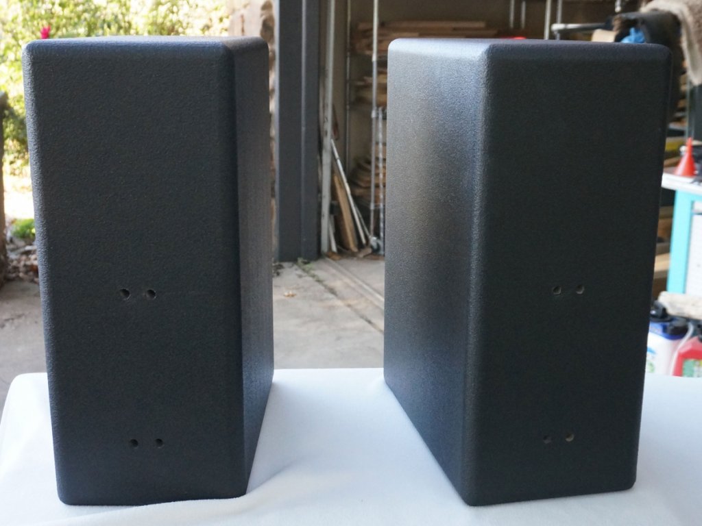

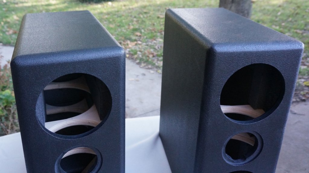

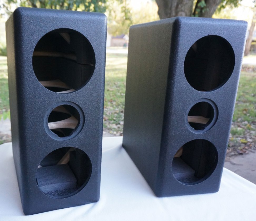

I finally got a finish that looks good with a low texture
Now to let them cure for a few days. By the end of this week they'll be ready to head to Wayne's house
Mike
cody69
« Reply #17 on: 13 Nov 2016, 11:40 pm »
The look great Mike... the textured finish came out really nice.
BTW, looks like holes in the back for 2 pair of tube connectors -- what's the plans there?

Wayne1
« Reply #19 on: 14 Nov 2016, 12:35 am »
I also agree that they look great. Thanks Mike!
The woofers and tweeter will have separate wiring going out to the two pair of tube connectors.
There will be separate boards holding the crossover components for each section.
I have had outboard crossovers in a couple of my earlier speakers and did prefer the way they sounded over having the components internal.
This will also allow me to try out different caps, coils and resistors very easily to see if I prefer the sound of one over another.
If I ever decide to try active bi-amping, the dual speaker connections will make that very easy.
The crossovers will start out with all Sonicaps, Alpha foil coils and Mills resistors.
I do have a fair amount of various brands of small value caps I can try out for bypass.
