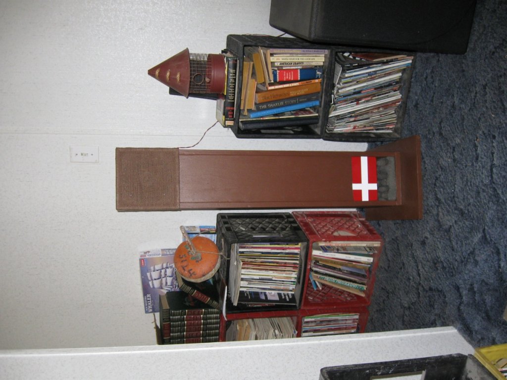

Hi GR, I just made a pair of speakers out of a David Weems book. They are of a pipe design. The stuffing didn't call for it but I put some Parts Express foam egg-crate at the bottom or throat of the speaker. As far as the sound I noticed this and was not looking for this.
   On the right speaker a bass guitar string was more noticeable than any speaker set up I've had. Most were Dynaco classic speakers with (aperiodic) ports. I used Acoustastuff all thru my speaker and egg-crate at the bottom.
   It was if the bassist was right there and plucked that string. I will not take the egg-crate out because I'm loving the sound and it might just be one of those luck of the draw sound experiments. I'm using a Vifa 6 1/2 inch coax I got a few years ago from Parts Express probably intended for cars.
