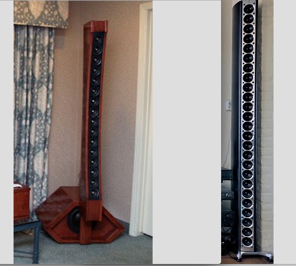

Was there any discussion on a line source ish using the 3 inch driver...  Something ......

In short, they don't work.
To minimize comb filtering of upper frequency ranges the acoustic centers need to be less then 3/4" apart. Or in the case of a continues diaphragm like a ribbon or planar magnetic driver then the surface edges have to be less then 3/4" apart.
And then you still have to adjust for comb filtering up and down the line.
When you run a line of 3" woofers like that (or 3" full range drivers) then the comb filtering effects cancel out upper frequency range output down into the 2kHz range and up. And the top two octaves are pretty much gone.
I heard a similar design at RMAF one year. And I thought to myself, what are they thinking? That will have no upper end at all. So I listened to them. And they had no upper range at all. No highs, no detail, no real resolution at all. It was pretty much just a mush.
If you allow only one driver to play full range and limit the rest of them to 200Hz or less then it can work really well. But to match sensitivities you typically can't use much more than four of the same drivers to cover the bottom end while allowing the one to play full range.
