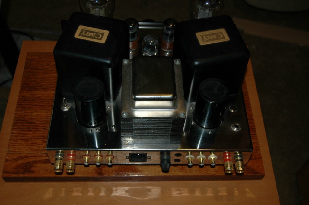

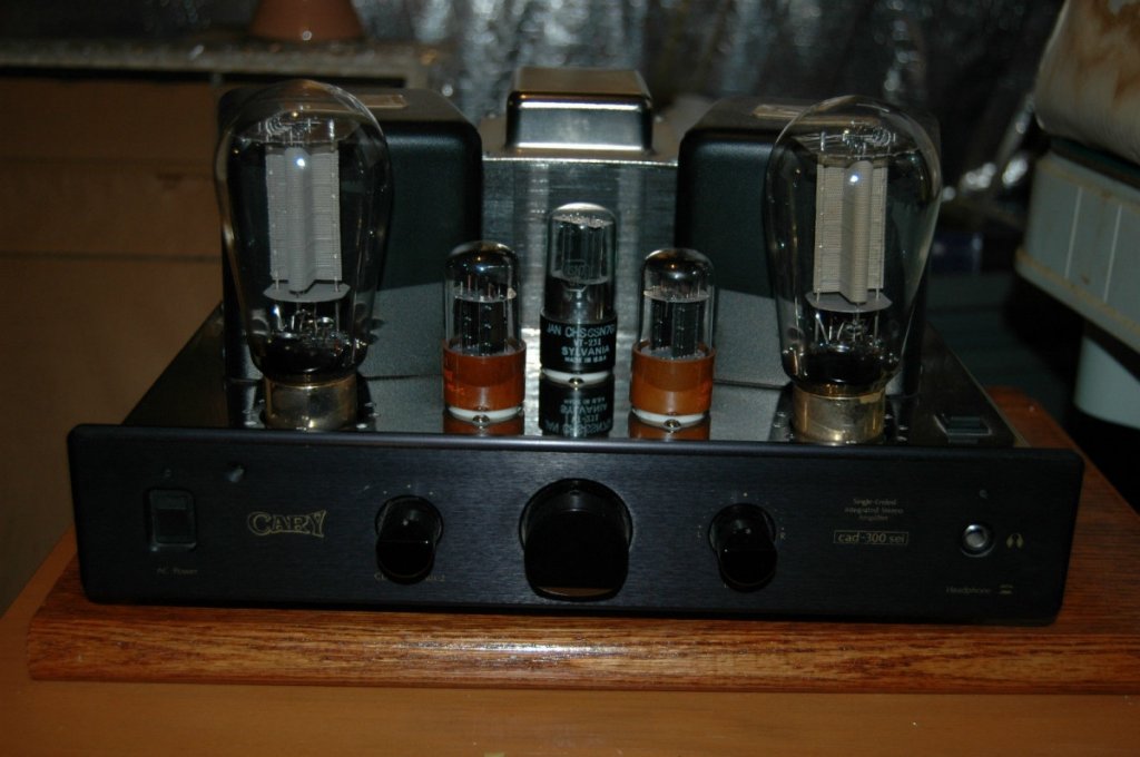

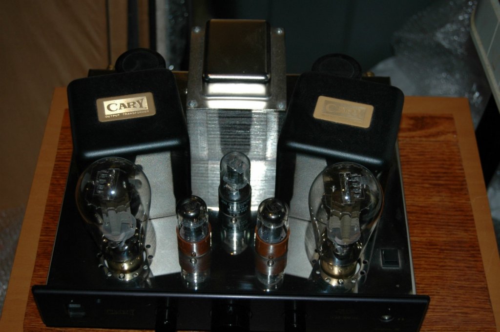

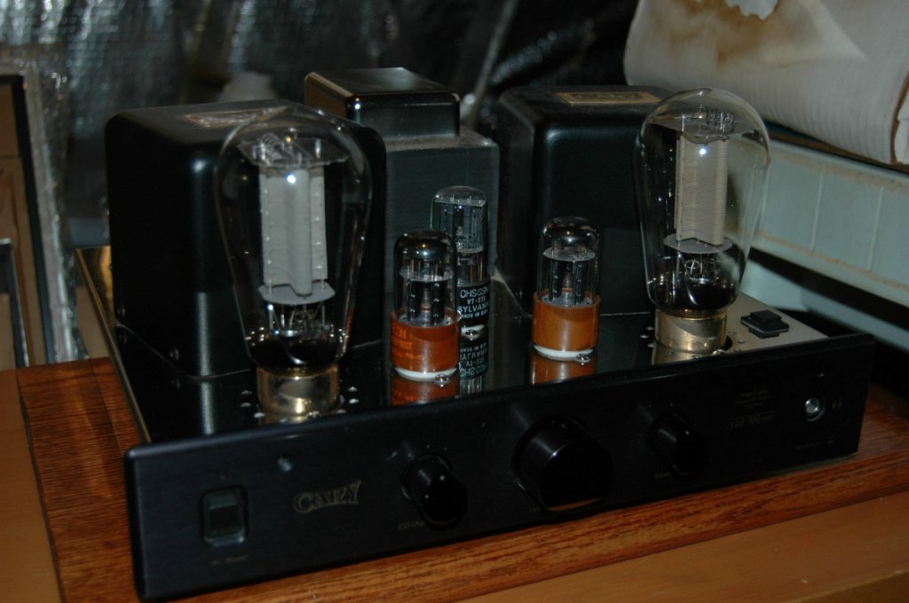

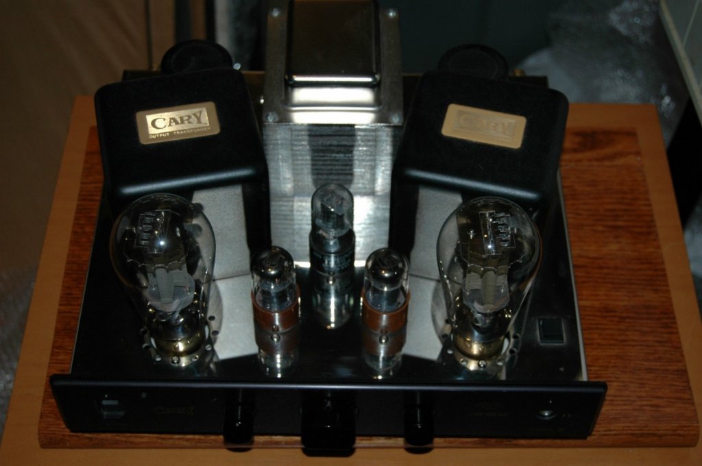

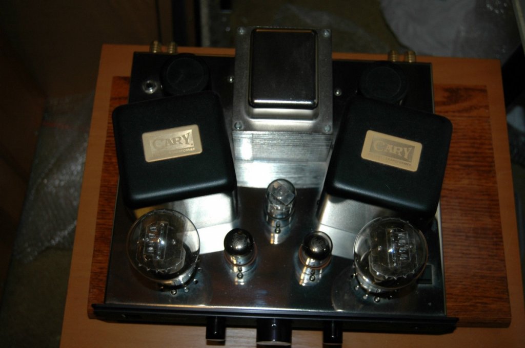

Available-

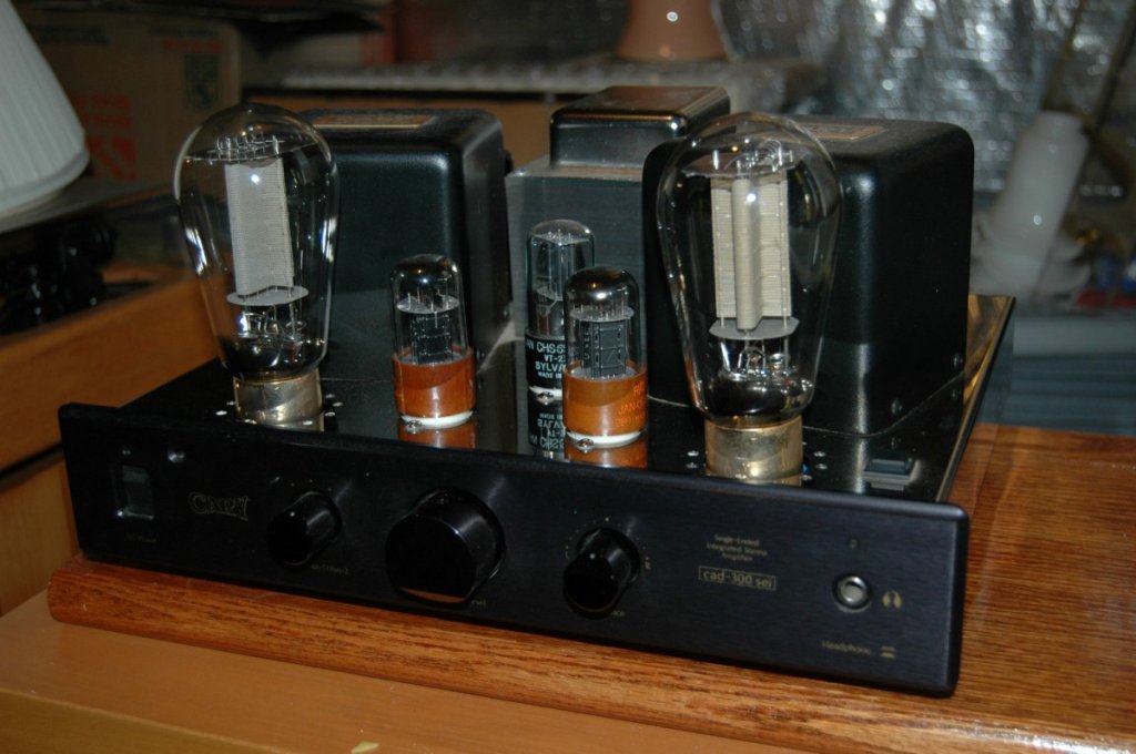

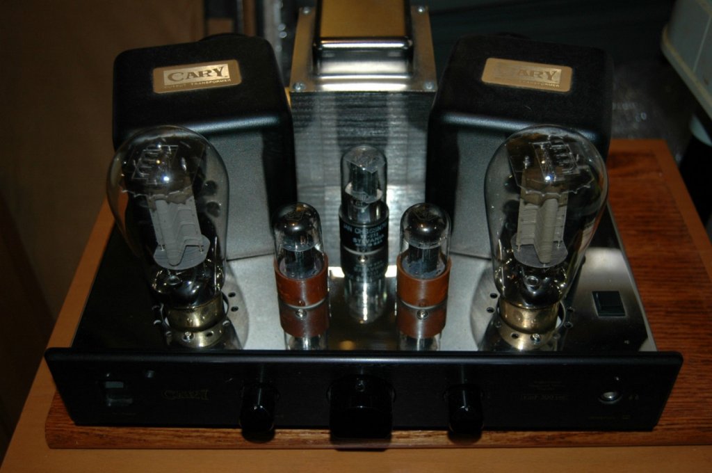

Excellent Condition - this award winning amp is probably the best known and best product Cary has produced, it is extremely musical and is probably the longest running high end product in the company's history.

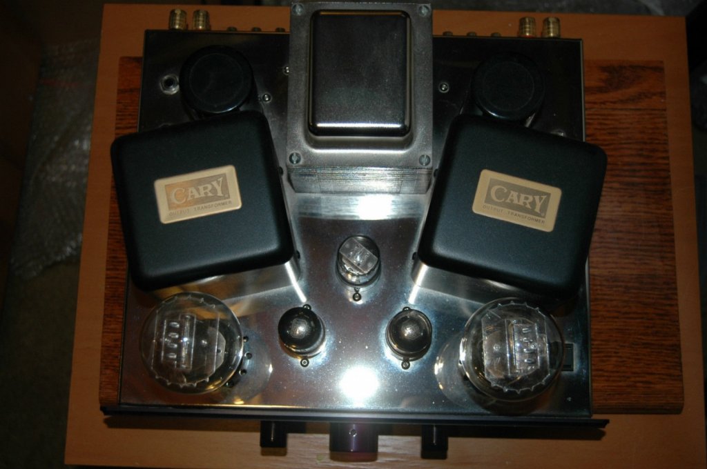

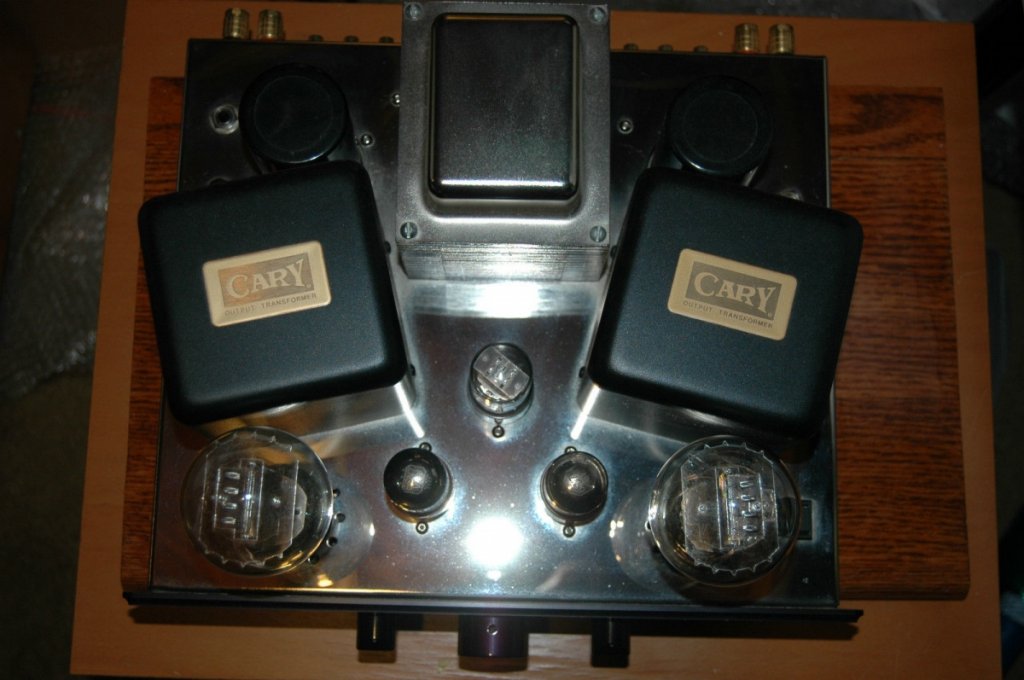

In addition to the outstanding sound, the amp and chrome are in excellent shape- very shiny with only very superficial scratches. This amp has been lightly used in one of my secondary systems, all tubes are strong and have only been used a few hundred hours. It is rare to find on in this condition. This is the auto bias version, the fourth version of this wonderful amp.
This one is preferable and more collectible compared to the later versions with the painted chassis and it costs less. Think of it- anything you would buy today, car, motorcycle, anything...chrome would be an upgrade to standard paint. This is another example of you getting more the money and better value with an older versus newer version. This comes with a pair of 300B output tubes (I think they are older Sophia's) and old stock 6SN7 tubes. It does not get much better than this for medium to high efficiency speakers and you would have to pay exponentially more. Headphone amp is among the best ever made. It gets the voices and instruments just right!!  If you do not want the supplied 300B tubes, you can deduct $200 from the total.
This is the best price for this amplifier online on ebay and all of the audio sites. There is one other amp on another site that comes in a finish cary never offered (so I would stay clear of that one if I were you.) This is the real deal.
Comes with copy of owners manual and will be double boxed and very well packed for its journey to you.

Description The CAD-300SEI is essentially two of Cary's CAD-300SE monoblock power amplifiers ($3800/pair) combined in one chassis with a volume control and a class-A triode line stage. The compact (14" by 14") 300SEI is a visual work of art, with a chrome chassis, shapely 300B output triodes up front, and angled output transformers. The review sample had the optional ($500) 24k-gold faceplate and knobs, further heightening its beauty.

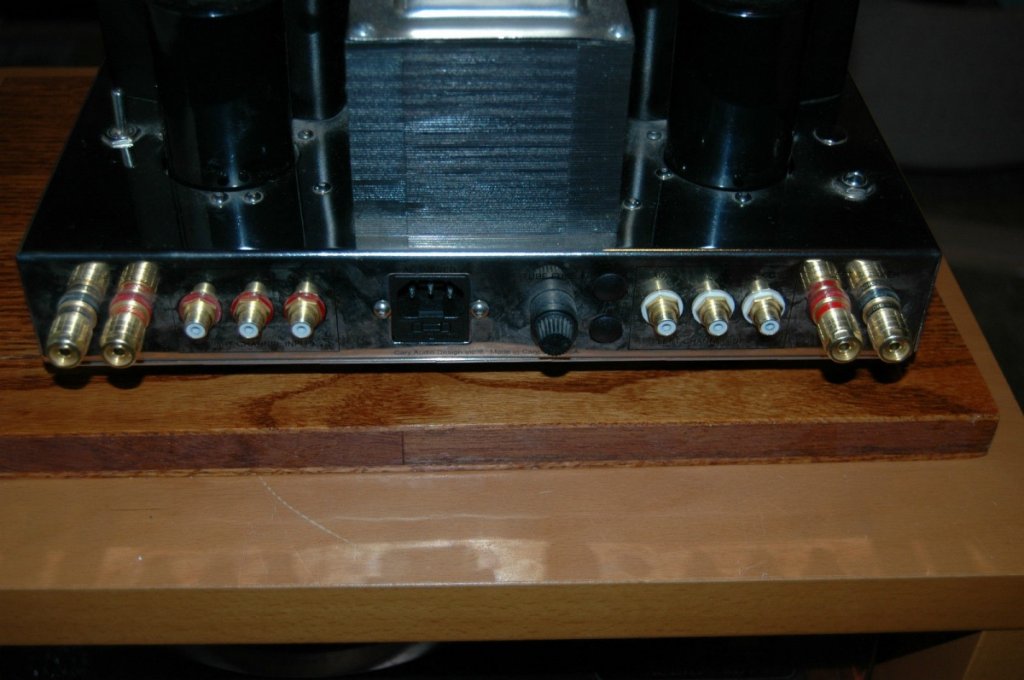

Three line-level inputs are provided on high-quality RCA jacks, with input selection via a front-panel rotary knob (footnote 2). A large volume control, smaller balance adjustment, and power rocker switch finish off the front panel. The rear panel holds the RCA input jacks, Edison-Price Music Posts for loudspeaker connection, a line fuse, and an IEC AC-line jack.
The front panel is also home to a ¼" headphone jack, which is activated by a small pushbutton on the top plate. This selects between the headphone output and the Music Post loudspeaker output terminals. When listening to the 300SEI through headphones, you're hearing the entire amplifier right off the output transformers—no op-amp circuits to drive the headphones here. Switching between loudspeakers and headphones is accomplished by a gold-plated 10A relay.
A ¼" 'phone jack on the chassis top provides access to the bias measurement point; simply insert a 'phone plug and measure the current flow with a DC ammeter. A trim pot next to the jack adjusts the bias. Not everyone has a two-conductor ¼" 'phone plug lying around; Cary should supply one with wires already attached.
The power supply is a full-wave center-tapped configuration filtered with a pi-L network. The rectifiers are bolted to the chassis top plate, which makes the entire amplifier warm to the touch when it's running. Two 1200µF and one 100µF electrolytic filter capacitors bypassed with polystyrene caps provide 230 joules of energy storage. Plate voltage on the 300B output tube is 430V. A "soft start" circuit powers the 300B output tubes' filaments first, then the high-voltage plate supply 60 seconds later. Warm-up time is said to be only three minutes.
The input/line amplifier stage consists of a single 6SN6 dual-triode tube, with one half of the tube used for the left channel and the other half for the right channel. This class-A voltage-gain circuit is the same as that used in the Cary SLP-90 preamplifier. This stage is followed by a pair of 6SN6 triodes (one per channel) in a constant-current, plate-loaded configuration, each of which drives a 300B triode output tube. No feedback—local or global—is used in the 300SEI. That's right, this isn't a low-feedback design—the 300SEI has zero feedback.
The 300B output tube is a classic triode design, with only three elements: the cathode, grid, and plate. Unlike nearly all other tubes in which a separate filament heats the cathode, the 300B's filament and cathode are one and the same, which gives the 300B the "direct-heated" designation. Seeing just four pins on the 300B made me realize just how simple a direct-heated triode is (footnote 3). The pair of 300Bs and three 6SN6 tubes are mounted in silver-contact sockets.
The output transformers, which are custom-designed for the 300SEI, are an E/I-laminate type wound with oxygen-free copper wire and feature an air gap to reduce the tendency of the transformer to behave as a big electromagnet. This is a danger with single-ended amplifiers because the bias current flows in only one direction through the primary winding. The two output transformers account for most of the amplifier's 42-lb weight. Indeed, the transformers look like they were designed to handle 100W each, not the 300SEI's 11W.
All the components inside the 300SEI are connected with silver-conductor, Teflon-coated wire instead of printed circuit boards. Looking inside the 300SEI gave me the impression that building this amplifier is labor-intensive. Resistors are 1% metal-film types throughout, and the bypass caps are Kimber film and foil. The volume and balance controls are made by Noble. The output coupling caps are custom-made, oil-filled types specially designed for the 300SE and 300SEI. The 300SEI's build quality, parts pedigree, finish, and overall look are exemplary.
