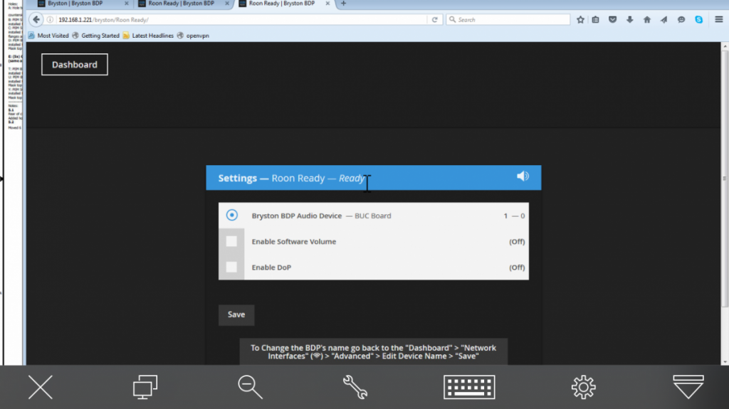

Chris, when I was testing, the bdp-2 was Roon enabled. I initially had bdp-2 connected to bda-3 via both aes/ebu and usb at the same time.  When switching between channels on the bda-3, it was outputting sound via usb but no sound via aes/ebu.  I thought this was due to bdp-2, so I rebooted a few times both bdp-2 and bda-3 to no avail. As soon as I removed the usb cable from both units and rebooted both, I was able to get sound again from the aes channel on bda-3.  Based on your comment, bdp-2 is outputting from both aes and usb channels, but my bda-3 is not as I was not getting any sound from the aes channel.  This is interesting because when I have both aes and spdif connected I can switch between channels on the bda-3.

^ sounds like the USB lane is over-riding the AES one. Blocking AES's channel?
Thx..
For Roon there are advance settings that can be accessed within either the services page or the Roon controller itself to customize output settings, like USB vs spdif or to enable DoP or software volume controls.
If the setting remain untouched yes, but once a selection has been made from the advance page it remains the priority device
