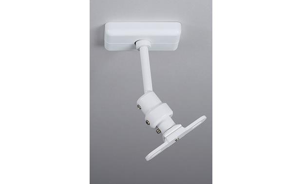

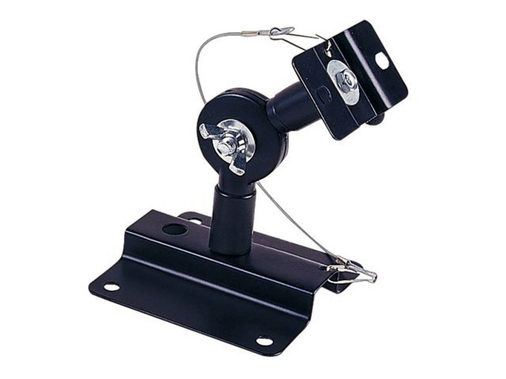

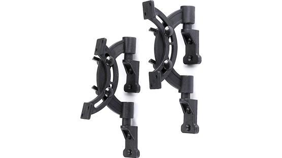

You could use a mount like these. The LGK's could probably be turned on their side to reduce how far they hang down from the ceiling if necessary.
http://www.crutchfield.com/p_121AM25W/Pinpoint-AM25-White.html
http://www.crutchfield.com/p_121AM10B/Pinpoint-AM10.html
https://www.amazon.com/Monoprice-106839-Adjustable-Speaker-Bracket/dp/B004C4XN86
Mike
Mike
Great ideas for the on ceiling LGKs. Do you think that this is a better option than "conventional" on ceiling designed loudspeakers?

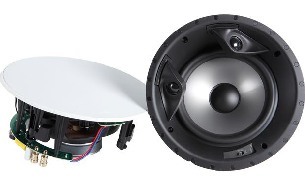

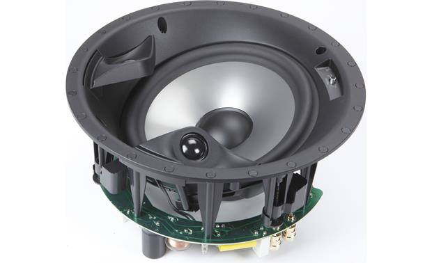

Santiago
By conventional on ceiling do you mean in ceiling mounted speaker (circular speaker which, when mounted, the grill is flush with the ceiling) like these (Polk Audio ceiling mounted surround speakers)?
If this is what you are asking about I can't really say, I have never listened to any.
Mike
Yes, that is what I was thinking.
Santiago
Mike
The cancellation effect of the dual tweeters on those is pretty significant. It creates a pretty big hole in the response.
