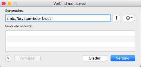

Marius
Re: BDP-1 Network Credentials invalid
« Reply #3 on: 9 Sep 2016, 12:15 pm »
did you try to login using the .local extension?
bryston-bdp1-.local usually works

I get this in my system when Roon service is running on my BDP-2. Turn it off and you'll ne able to access your SMB drive. Once accessed, you can turn Roon Service back on (works for me, anyway, but, most likely, is OS dependant- Win 7 in my case). If you disconnect from the SMB drive you'll have to repeat the whole procedure.
Hope this helps
« Reply #7 on: 12 Sep 2016, 09:08 am »
Hope this helps
Check.
Ive reported before to this forum (in the BDP Roon thread) and Chris that enabling Roon Mode disables SMB connections in my setup, and quitting Roon fully establishes SMB . 100% repeatable. BDP1.
Chris however dismissed this as not possible.
Should be further investigated it seems...
Chers,
Marius
