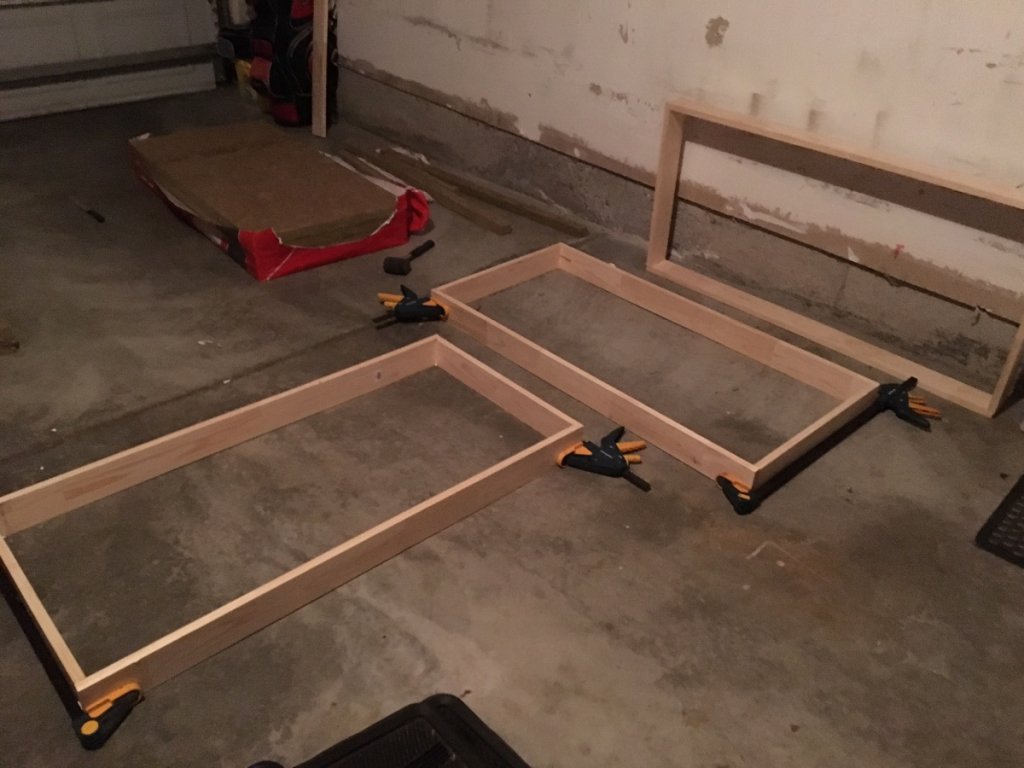

« Reply #5 on: 19 Aug 2016, 04:21 pm »
Bought 1x4 pine this AM, and am clamping together the frames for the 3 DIY traps.  Decided to use 2 layers of the 1.5 inch Roxul Comfortboard for those and save the Roxul safe n sound for corner bass traps.
Should be able to get 3 done today and begin experimenting with placement.
Bought 4 thinner panels off a local place that builds them.  Will use 2 of those as ceiling panels for first reflection points.
Will use the other 2 as the "face" for my DIY corner traps.  Easier than building an actual frame for those etc.

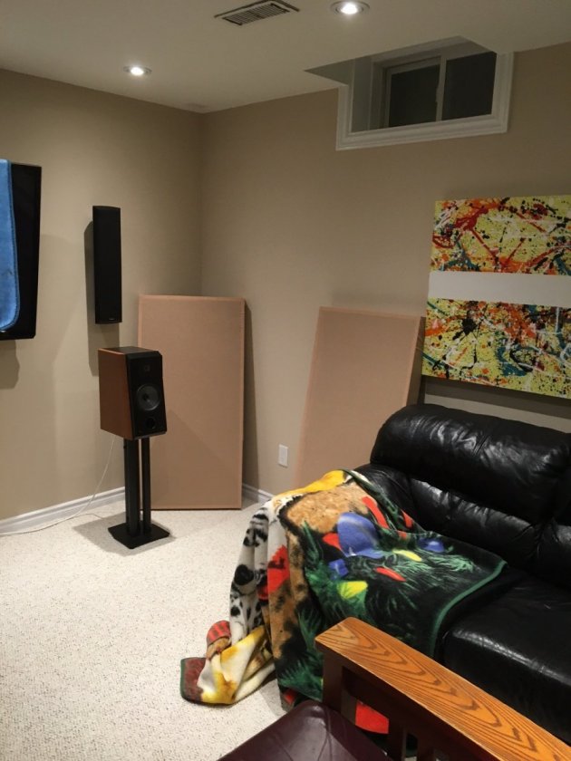

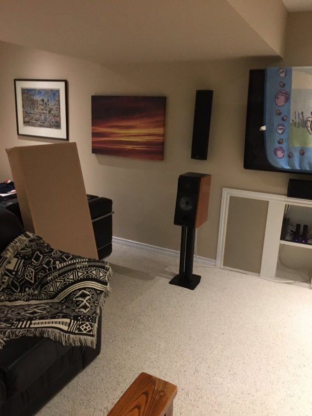

« Reply #6 on: 19 Aug 2016, 07:01 pm »
3 panels built and in place.
More conference calls yet today so I won't get to listen until this evening at the earliest.

mcgsxr
Re: DIY panels
« Reply #12 on: 20 Aug 2016, 07:00 pm »
I built the panels in the garage, so I had little concern about the worksite.
I finished off the rear of the panels this afternoon.  My daughter picked out the second fabric, again a close out at the local Fabricland.
My wife has yet to bless which side will be prominently displayed!  i assume the beige, but it does not matter to me.
Early reactions to the sound are mixed.
On the upside I can hear further into tracks, and I can hear detail without straining to interpret it.  Wider soundstage for sure, and improved imaging.
On the downside it makes it clear that my plan for bass traps is a wise one, and cannot come too soon.
I used 2 layers of the Comfortboard in these traps.  It was easier than trying to combine the Safe n Sound with the limited depth for the panels I was willing to live with.
I will use the Safe n Sound as superchunk style traps next week.

I played around with placement last night, and did a lot of reading about how best to arrange and mount the panels I have made.
I decided on using 1 vertical panel on the right wall, as well as 1 horizontal panel there.  Should catch both first reflection points for both speakers this way.
I built up a small (24x24) panel with my leftovers and placed that on the left wall.  It should catch both first reflection points for both speakers, and the wall is further away anyway.
I bolted my last trap across the rear right corner by the pool table.
All 4 of my DIY traps are effectively 3 inch of Roxul, and a 2.5 inch gap.  Best compromise I could come up with to use them well, and still be able to use the room effectively.
Once the pro made pieces come next week I can treat my first reflection points on the ceiling, and also straddle the L and R front corners.  I intend to fill in behind them with Roxul Safe n Sound (basically 4 foot high superchunks with a panel in front of them).
That will give me 3 corners treated, though only 4 feet high.  I cannot go all the way to the ceiling in all 3, though I could extend the front right corner to the ceiling.
