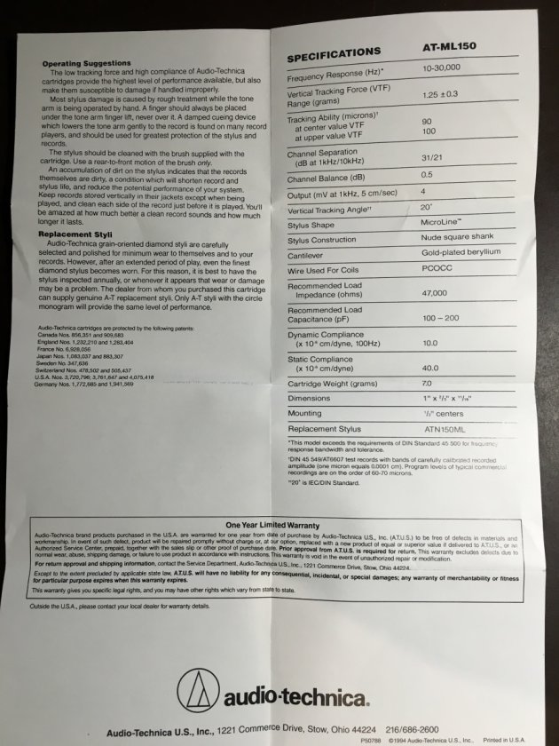

Just to add...Apparently this cart is one of the best AT has made, you'll love it!  Pity it's discontinued. The VTF is actually 1.25 +/-0.3. Oddly, too little VTF can cause more wear than more VTF.
Pic from my ML150:

When insufficient VTF is used, the stylus literally rattles back and forth chattering its way down the groove, generating tremendous forces at each point of impact along the way.
 This damages the record immediately and the stylus in a very short period of time.
Scotty

Thanks much for the AT info.
That light VTF is a concern to me. I have limited experience in vinyl, but I don't think I've ever seen one that low
Nick

Makes sense.
I remember in my early spinning years, some pressings had so much bass I would place a dime on the headshell in order to keep the styli from dancing around.

If audio-technica gives you a VTF range you should be safe if you stay within the boundaries. I run an AT 440ML with a AT150 MLX stylus and I set my VTF based on the HI-FI New and Record Reviews test recording tracking test bands.  See link below:

Didn't think about a test record, although I've used my test CD numerous times. The stylus looks to be very fragile.......
