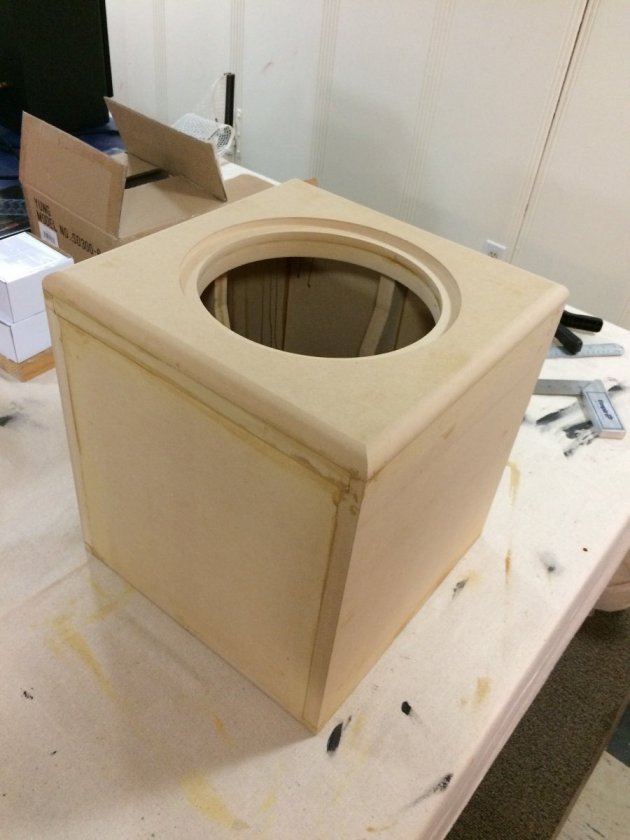

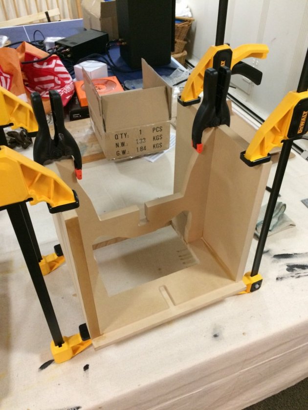

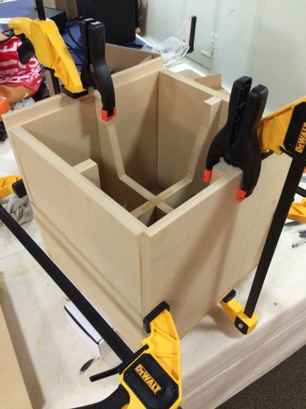

Originally, I was very impressed with the DIY Sound Group's flat pack for the speaker cabinets, so I decided to go with the Parts Express 1 cu ft flat pack (supplied by DIY Sound Group) combined with the Dayton 10" Reference HO driver.  The 3/4 inch MDF panels were even easier to assemble and more precisely cut than the BB plywood panels of the Fusion 8.
Here are some images:

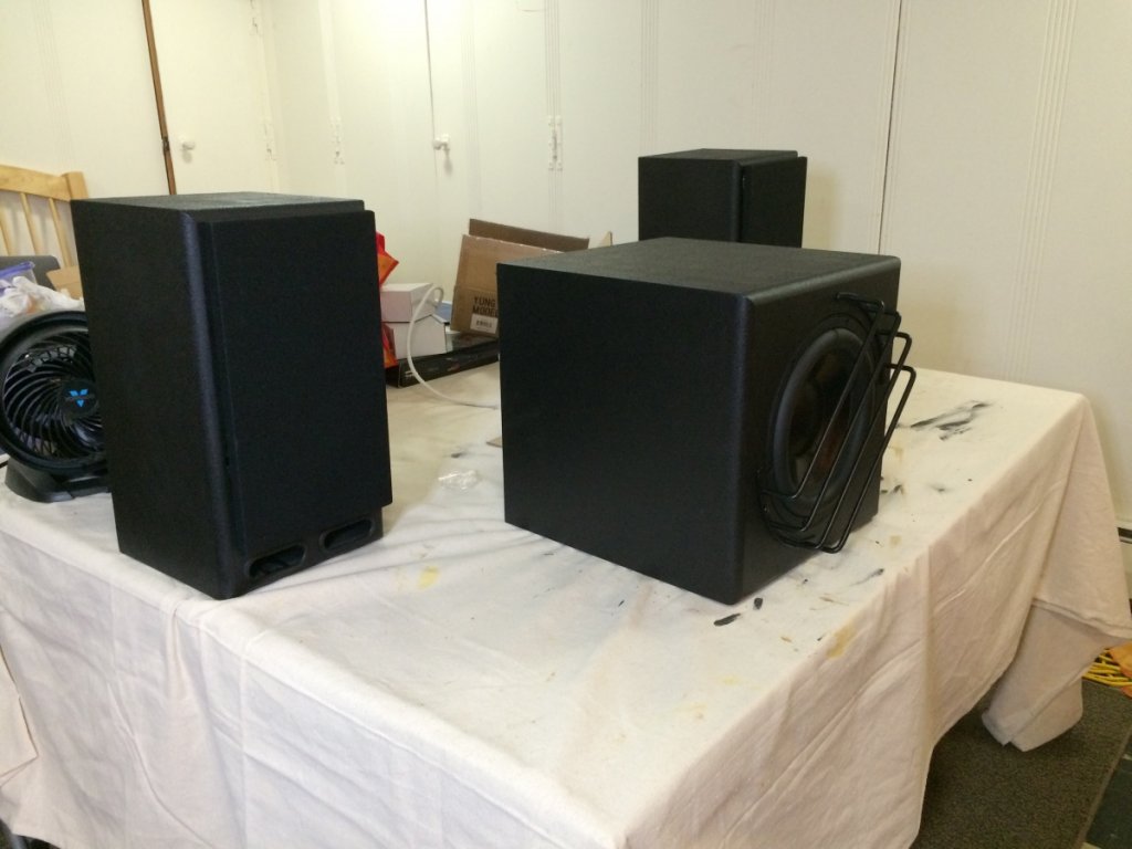

After sanding the cabinets we decided for consistency to use Duratex paint. I have to say the second time is a lot easier.

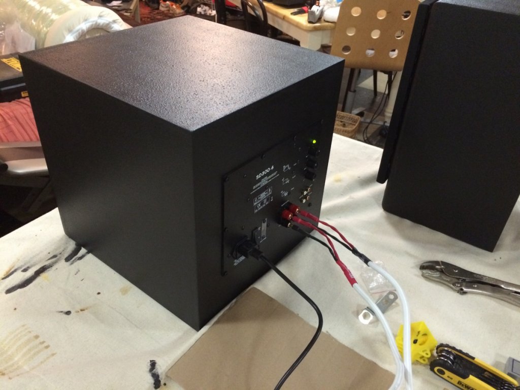

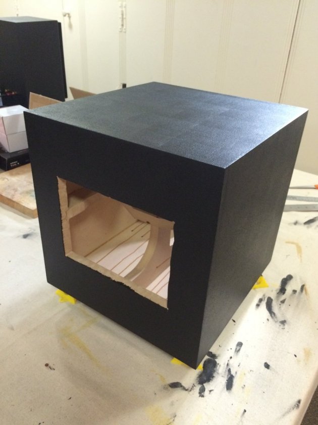

The cut out on the back is for the Yung SD300 class D plate amplifier. The back panel came already precisely marked but we had to cut it ourselves.
Remembering that Duratex needs time to cure we waited 4 days before the final assembly. Again, it was very easy.

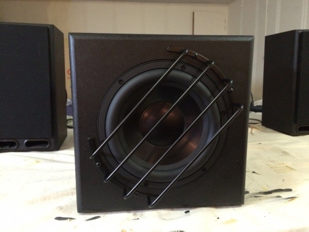

The final touch was a metal bar grille that my son decided to attach diagonally. It does look very interesting this way.
So, how does it sound. With no break-in and no care about placement, I have to say that music is rounder, fuller, more life like and has that great, visceral component.

I forgot to mention that the reason I picked the Yung SD300 plate amplifier was due to it's class D operation and it running cool. There were some complaints about the Dayton amplifier running hot and some people being concerned this would lead to failure over time due to components of the amplifier overheating.
