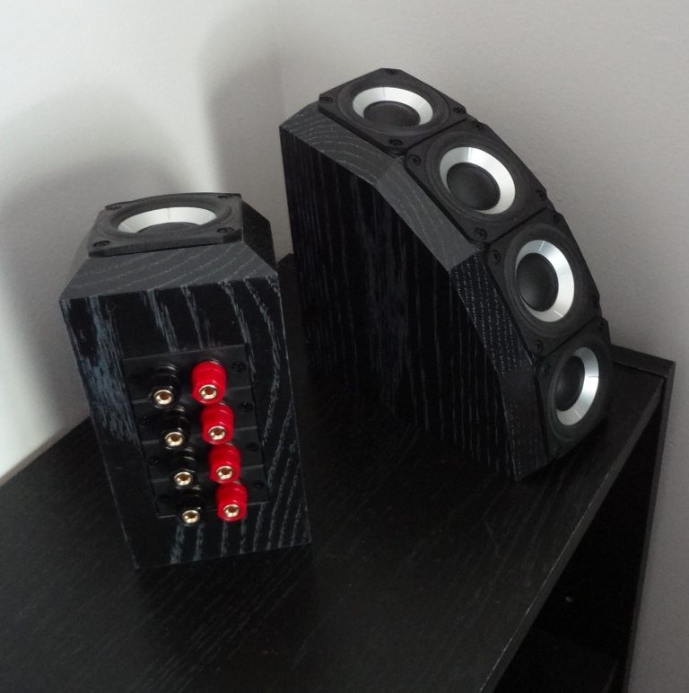

Named in honor of Don "DB" Keele, the crazed CBT inventor...

So many binding posts... is that for quad-wiring or is there actual full quad-amping external crossover shenanigans going on there?
Also, this seems like a perfect time to use a Neutrik Speakon 8-pole connector.
Yes, the Neutrik would be easier; however, I wanted to easily change from all active (four channels) to passive (one channel) shading / attenuation. My wife has a saying "just because you can doesn't mean that you should". In this case I did because I could. That means using a MiniDSP  with eight channels of outputs and an amp with twelve channels. Using resistors I only need two channels.

Will you implement a way to easily switch between 2/8ch mode?
Also... why would you need 12ch of amplification? Do you have a centre channel in there as well?
2-channel is obviously more practical / economical so no plans for making it easy to switch. The main reason for the four inputs was to make it easy to test and show how a CBT operates. I have a 12-channel amp I use for testing but could have used four stereo amps or eight monoblocks.

What are the dimensions on these? They look like they could make for a nice desktop system if they're ok in nearfield.

Fair enough.
7" high , 3.5" wide, and 7" deep. I use equalization to extend the bass and they work well for nearfield listening.

Oh wow that's much smaller than I thought. So those are... 2" drivers?

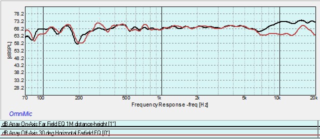

Here's an on-axis curve and off-axis (30 degrees horizontal) taken with the speaker on a monitor stand (and the usual floor dip reflection at 200hz). DSP equalization was used to flatten the response and extend the bass. The drivers are 2.5" from SB Acoustics. I usually don't like full-range drivers but these are much better than the norm.
