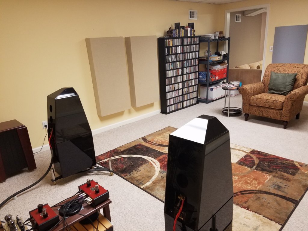

Recently purchased a home with a mostly-finished basement and just set up my gear. Man, it sounds terrific already, and I haven't even taken any measurements nor turned on my subs yet. All treatments by GIK (two pairs of tri-traps, four bass traps at first and second side reflection points, and three combination absorption/diffusion) seem to be doing their job. I haven't have much time yet to listen or integrate my subs, but at least it's all unpacked and set up. Finally, after almost one year in storage!  :hyper:
I needed a platform of some type for my two-box (red) preamp but could not find any Craigslist/yard sale suitable, and I have no budget for a real platform, so I built and stained that little table you see for it. Nice and solid, and perfectly dimensioned for my needs. And since I was not using my original speaker spikes, I attached them to the table's legs. So all gear is now spiked to the floor (carpet over concrete).

I set up the speakers using the Cardas method. I was surprised how close together they ended up (approx. 6' apart). I originally set my char 6' away for an equilateral triangle. Ugh! Sounded like crap! I inched my chair back, back, back, giving the drivers a chance to seamlessly integrate. Until finally, bingo! Found the sweet spot, and now they sound terrific. Whew! That was scary. I mean, it really sounded horrible until I put my chair in reverse and gave my speakers some room to breathe.

I was thinking your chair looks too far back. I agree that moving back a little from the equilateral triangle position sounds better but I think the listening position should be about 38% from the back wall. Here's a link to the very helpful setup guide I found:
http://realtraps.com/art_room-setup.htm
Very nice looking setup!

Thanks toddc2. Thanks for the link. I wonder if I could have achieved better sound near my original seat position if I were to toe the speakers in much more, as per the referenced article suggests.

I try to have my speakers 3ft from any walls. If that's not possible the min between them is 6ft. I sit somewhat close but I've found toe in just causes lots of comb filtering with my electronics. While using other devices that wasn't the case probably because they were so much softer and less bodied in general.
You could certainly try what I'm suggesting, to move the chair much closer but NOT toe the speakers in much at all. A few degrees like they are now might be plenty, maybe even a hair much.
The comb filtering utterly destroys imaging, btw.

My room is 8ft x 13ft x 21ft (Cardas) and I used the Cardas near-field setup (68 inch equilateral triangle) for years (with my 30-20k single driver speakers).  Naturally no integration issues.  Have since spread my speakers out to make a 120 degree angle from the chair (about 10.5ft apart) and very close to side walls which has enlarged the soundstage.  Also replaced the small rack with a single shelf on the floor between the speakers.  All made possible by having a dedicated room.

Maybe 7' apart with a bit more toe in & adjust
you chair as your ears & Mic suggest.

Thank you all for the kind compliments. A little embarrassing that my treatments are three different colors, but they are what they are. And I listen with very dim lighting anyway.
Bob2 - Eggleston Works Fontaines (originals). Dang! I should have removed their grills for the pictures.
Folsom - Yes, I agree. I'll likely be moving stuff around for months. But that is one of the fun aspects of this hobby. Free tweaks are the best!
Carl V -  New room dimensions: 20.125' L x 12.67' W x 7.10' H ; carpet on concrete. Just a simple rectangle.
Old room dimensions: 24' W x 26' D x 8'-11' H (cathedral ceiling) suspended wood flooring. Very open to half of the house.
