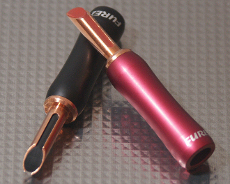

The banana plugs I recommend are the BFA (or "Z") type or the locking type.  I don't recommend the standard spring contact type as they have the least contact area and retention force.
BFA or Z-type Bananas
The BFA (or "Z") type use a thin, slightly tapered split tube that maintains contact for a high percentage of the surface area (which is more area than spade connectors). They are a tight fit in most binding posts, but I have run across a few posts whose ID were a bit larger than "standard" and the fit was not as tight (but still better than the spring contact type).  They are minimalist low-mass, which is generally a good thing.
Because of the requirement to have springiness to maintain good contact, they are most often made from a gold-plated beryllium copper alloy, so they are not pure copper.  There is one I have come across (but not yet tried) that shows high promise, made by Furez, which is made from pure copper and uses an elastomeric insert to provide the contact pressure.
Locking Bananas
The locking type banana has a solid contact pin split down the middle which is expanded by another smaller center pin as the threaded collar is tightened.  These provide the greatest contact force but a little less surface contact area than the BFA/Z.  They are usually fairly high mass.
The inexpensive ones are usually gold-plated brass with less copper content than the beryllium copper, but there are also some higher end ones made from either very high copper content brass or pure copper.
The metallurgical content of either style plug (as well as spades) also brings into question the construction of the mating binding posts.  They vary widely in quality and copper content, but other than DIY projects or those blessed with speakers and amplifiers coming from the factory with high quality binding posts, few of us are going to modify a good stock component, particularly if under warranty.
My personal favorite so far has been is the Multi-Contact LS4.  Swiss manufactured, low mass and not extremely expensive (< $25/8).  They do require soldering as the hardened spring alloy would break if you tried to crimp.
If you're a set-screw type of person, Audioquest makes a decent quality version, but more expensive at ~ $40/8.  I do have a set of these on my surround speakers, but if you can solder, why introduce one extra mechanical connection into circuit?

BFA banana plugs are all that I use. Spades are at the mercy of a wrong twist of the connector body (righty-tighty, lefty-loosy). BFA plugs put a constant direct pressure to the inner barrel of the speaker terminal and have a larger area of contact.

The beryllium copper alloy used in the banana plugs has 10% electrical conductivity when compared pure copper which is the standard at 100%. So in this case the electrical conductivity of the alloy used in the connector is limiting factor rather than the total surface area involved in the connection.
I don't have a conductivity meter but rudimentary current and voltage measurements haven't shown any reduction in current or voltage drop across the connector, and they sound good (I've also tried bare wire and copper spades), but I do like the idea of pure copper, and if I get my hands on the 100% copper Furez BFAs, I'll report back.
I don't have much experience with dissimilar metals in speaker connections over time, specifically bare copper (the Furez BFA are bare un-plated copper) and gold-plated brass (all of my binding posts), but I assume some people have to be using that combination.  If it's just a matter of copper oxidation, a ten second burnishing with synthetic steel wool per terminal once or twice a year is an easy and not unreasonable task.
