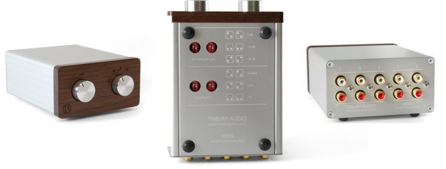

This little Tisbury passive showed up today from ups and if it's any indication of the possibility for the Hattor I think I'll be a happy camper. The dial is between 12 and 1 and its pretty loud on certain tracks. For $200 shipped this a nice little piece! The dial does jump quite a bit in reference to volume so the 64 step on the Hattor should be quite nice.
