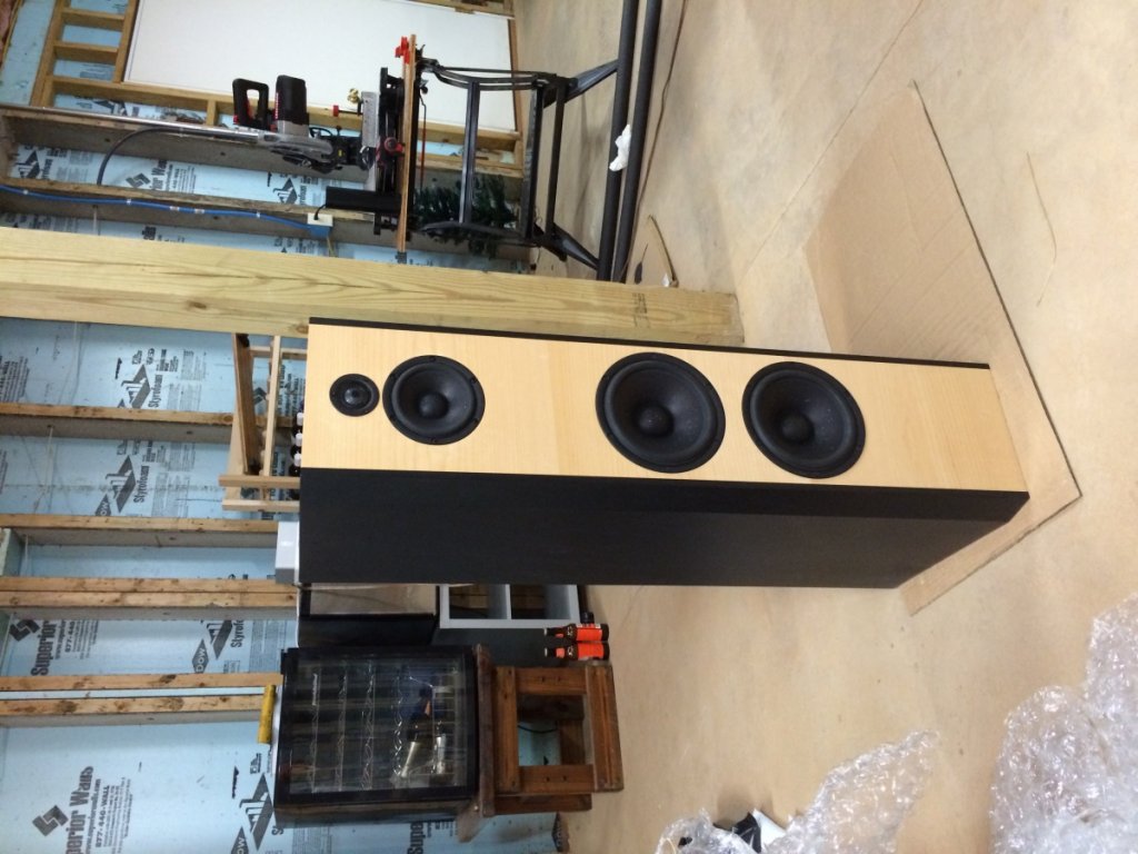

I finally finished this project.  Initial listening is very positive.  Doing a little break in before moving them to our living room.  Very happy weth the results.  Thanks Rick for the great design.
richidoo
Re: Satori/ Illuminator project completed
« Reply #1 on: 25 Jun 2016, 03:26 am »
Hi Gary, welcome to AudioCircle! Congrats on your successful speaker project.
Did you build those beautiful boxes?
Please let us know how you like them after they break in and when you get the new system settled. Thanks!
Is that the new MR16P-4 midrange driver?

I have a two way that uses the Satori drivers that I really like but I was wanting a set of towers too.  After studying the Revelators and illuminator woofers I decided that the Satori would be my best choice.  I contacted Rick inquiring about his TRT design and told him that I really liked the Satori drivers.  Rick suggested a 3 way using the beryllium Illuminator tweeter.  So, we ended up at two 7.5" woofers and a 5".  The 5" is the Satori woofer, not the new mid which I don't think is available yet.   Rick designed the crossovers and put together a kit for me.  It was a great experience.
   As far as the cabinets.  In order to get them up and running faster, I decided to have some cabinets built.  Lee Taylor was the maker of the cabinets.  They are built like a tank.  1" mdf with 1.25" sides.  They are rear ported.
I chose Lee because I live close enough that I could pick them up.  Lee is a fine gentleman that shares my enthusiasm for speakers and he even has some pretty great designs himself.  Overall, I am very pleased with this build.

Excellent info, thanks Gary! Yeah, that looks like Lee's style with the horizontal wood grain. Very distinctive.
Looking forward to your listening impressions later on.

The cabinet design is 40" x 9" x 15" and houses dual Satori MW19 woofers, a Satori MW13 midbass, and Scan-Speak beryllium dome. With a 4-ohm impedance and 90db sensitivity they will play LOUD with a minimal amount of power. The design can be front or rear ported for easy placement. A kit is $1,700 /pair (just add cabinets and damping material) or assembled for around $5,000/pair (both prices include shipping to the mainland USA).
