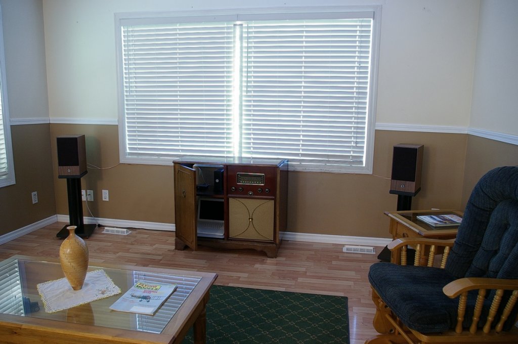

I'd still stick with an RS5 based speaker though.  I've had Super 3i's in a big space with no negative issues.  They were about 11 feet apart and about 10 feet from my ears with no imaging issues other than soundstage could have been a little deeper.  In this setup I only had an Audio Engine N22 in front of them.  I think a nice SET would have deepened the soundstage or moving the speakers out further into the room.  Bass was adequate, and sometimes I ran a sub and sometimes not.  Was this the best room setup?  No, but for a system that had to integrate with the other decor, it worked well.
See picture.

I'd still stick with an RS5 based speaker though.  I've had Super 3i's in a big space with no negative issues.  They were about 11 feet apart and about 10 feet from my ears with no imaging issues other than soundstage could have been a little deeper.  In this setup I only had an Audio Engine N22 in front of them.  I think a nice SET would have deepened the soundstage.  Bass was adequate, and sometimes I ran a sub and sometimes not.  See picture.
Too much reflected sound kills the soundstage and makes it 2 dimensional. This is why nearfield can work so well, more direct vs reflected sound... and given the SPL limits of single drivers they don't have to work as hard for the same SPL at the listening position. With the RS5 speakers I'd want to be about 6 ft away or maybe even closer but not over 8 ft away.
Also, you really don't want your listening position to be near any room boundaries, this can also kill soundstage.
