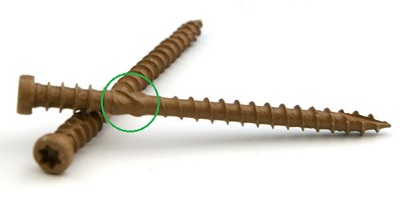

If you mean these... You have to press real hard to get them to go, and if you're not absolutely sinking it fast at the last moment the head can stick up. Then you can't get it in, it'll just spin. But even so when it goes correctly, Trex often creates a bulge around the screw head, so a little pre-drill goes a long ways (and I mean little, like 1/4in) prevents it, but it won't leave it flush with the top.
An AC drill is more useful for decking...

I'm not sure all composite deck screws are created equal.
The GRK Kameleon screws have a few features that make it easier to get good results.  The CEE portion of the thread enlarges the hole through the deck board and the underhead cutting teeth effectively bore a countersink.

In theory. I'd like to see it first. Those look like what I used. However GRK makes very good screws for other applications so who knows.
