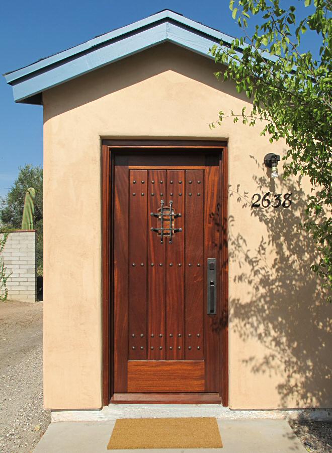

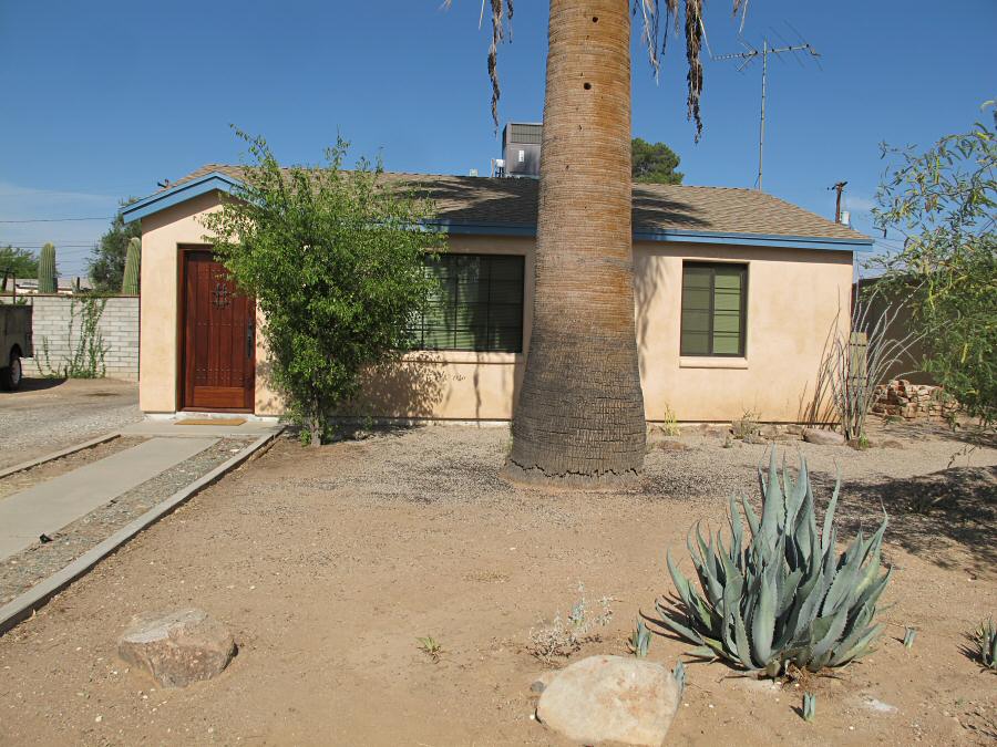

I finally designed and made a new front door (my day job) for my house and installed it a few weeks ago so the next part of the story can be told:

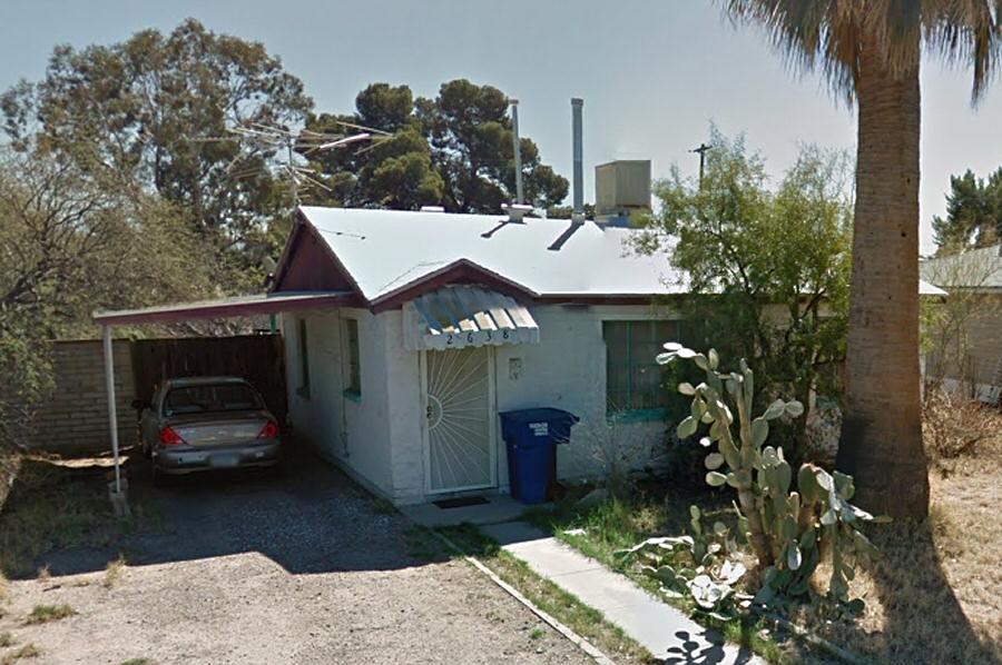

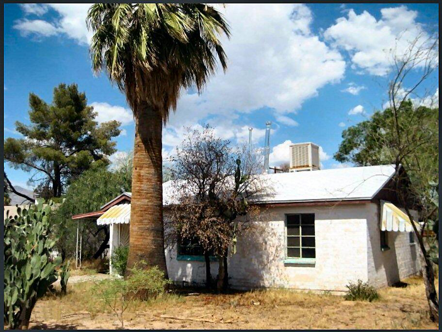

My little 2 bedroom post-war house was built in 1950 and needed a bit of sprucing up. I bought it "as is" knowing that everything needed to be replaced. The house was pretty much gutted and is slowly being put back together. Below are a couple of photos taken in 2011 by the Google car just before I bought the house.

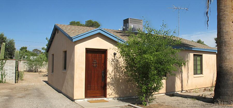

The yard was cleaned up, awnings removed, Marvin Integrity Low E3 windows replaced the original steel casement windows, a new roof with R40 insulation, high efficiency A/C, and a marble dust plaster over 1" rigid insulation makes for a very energy efficient comfortable house. The remodel cost much less than a new home and has no compromises.
The new Low E3 glass coatings are amazing, I originally thought the West facing windows would need awnings. I live in Tucson and a few days ago we had three 113 degree days in a row so there is a lot of afternoon heat gain but with the Low E3 coating I get practically zero heat gain and as a bonus almost all the UV is filtered too. Highly recommended!

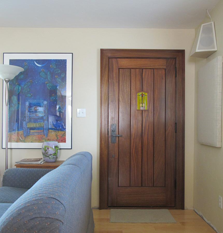

The new Arts and Crafts style mahogany door ties all the exterior elements together. The door includes 40 bronze rivets, a hand forged wrought iron grill and custom stained glass. The entry handle is by Ashley Norton Hardware.

Quite the transformation Wayne.  :thumb:  The door is stunningly beautiful, and I'm guessing fairly secure as well. Nice job.  8)

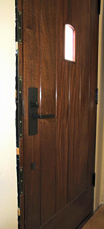

... and I'm guessing fairly secure as well. Nice job.  8)
The jamb is bolted to the concrete block but the bolts will work loose over decades so I sprayed minimal expanding polyurethane foam between the block and the jamb, besides insulating it makes an excellent glue. The blacksmith and I came up with a 4' long steel reinforcing plate made from heavy angle iron and attached with 3" screws and a lot of 1-1/2" screws on the backside. The plate is recessed and the cutouts to allow the inside casing to be nailed on flat. The steel is completely hidden with the casing installed.
