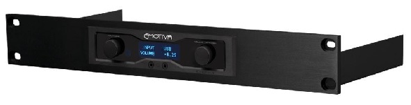

I think the Emotiva Stealth DC-1 half-rack 1U DAC meets your requirements, and there is an an available RK-1 Rack Mount Kit for it.
Steve

That could work - thanks, srb!  No explicit mention of Linux support, but it looks like the USB chip is the cm-6331a, which is commonly supported.  Price is is likely to be an issue, but I'll keep it on the list.  Too bad the XDA 2 is discontinued... that looks like it would have been perfect.
Unfortunate that the UD-301 is taller than 1U (1.75")...
