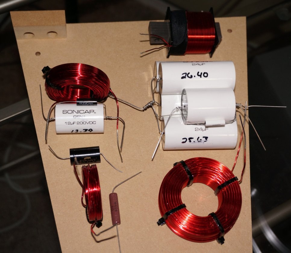

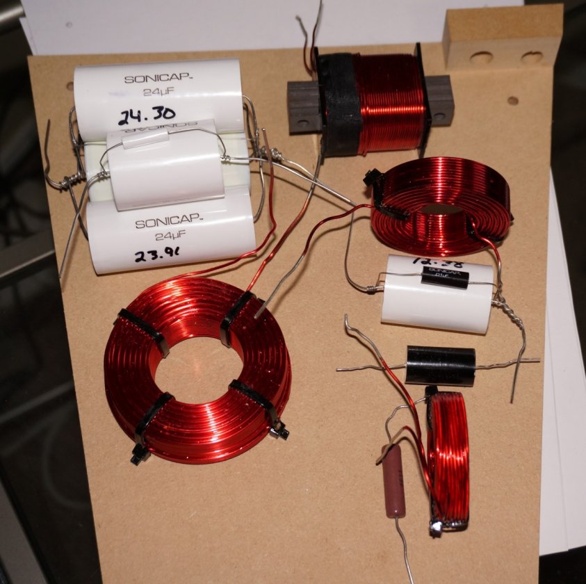

Next question. For the crossovers I'm building I have been asked to keep the components a couple inches back to give the drivers more room to breath. With this in mind I have two layouts to ask about. They are basically the same except for the location of the big iron core inductor.
Is one of these layouts preferable?
Mike

You're not going to inhibit any breathing of those lower drivers with crossover placement.

That's kind of my fault, I asked Ron  to do  that with mine as I wasn't sure if the magnet on the lower woofer would  , or could, cause any  issue.  IIRC, I mentined it to Mike's  customer...obviously I shouldn't have been worired about it
