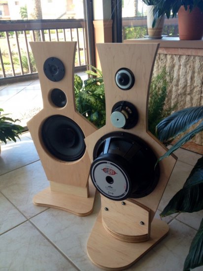

matevana
If you want to try something a little more challenging (rewarding), the Hestia V Dome's can be had with a high efficiency woofer that will work well with SETs. It's also available as a flat pack, so you would only need to assemble the parts.

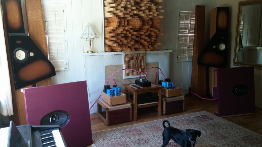

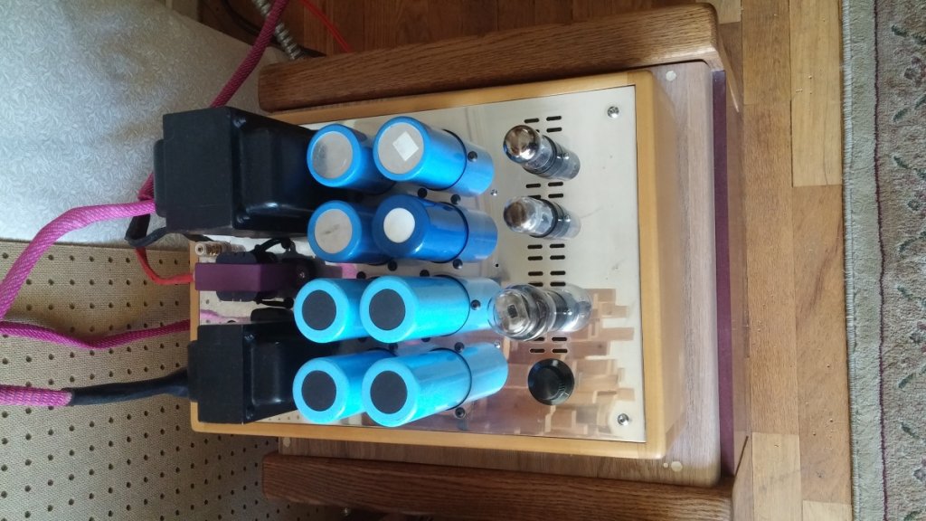

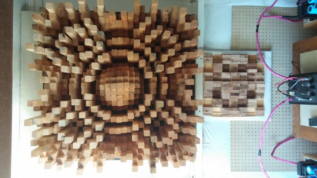

BenjaminWebber
BenjaminWebber
I decided to try posting some pictures that show my room, amps, and 2nd experiment of sticking an old driver on a baffle with my Fostex 166 Voigt Pipes and 208 sigma BIB's in the background.  And also the crazy diffusor (which really helped the sound!) that I built.  Sorry some came out upside down.
Sincerely,
Benjamin

mresseguie
  • Posts: 4958
Hello, Benjamin.
I can't offer you any ideas on OB (rank beginner here). However, I really like your diffusor. Did you use 1/2" or 5/8" plywood and 2" wood screws to mount all the 2x2s (or did you use a lot of glue)?
Thanks for the pics.
Michael

flavo
Hello, Benjamin.
Michael
As a previous wood working professional   :o  I can say that the thickness of  Ply doesn't really matter. The 1/2" will be lighter and therefore easier to move.  You only need about 1/2" of screw sticking into the wood. So with 1/2" ply I would use anything that was an inch or longer and a bit of glue. Not so much you need to do excess clean up, just because it's a PITB.
