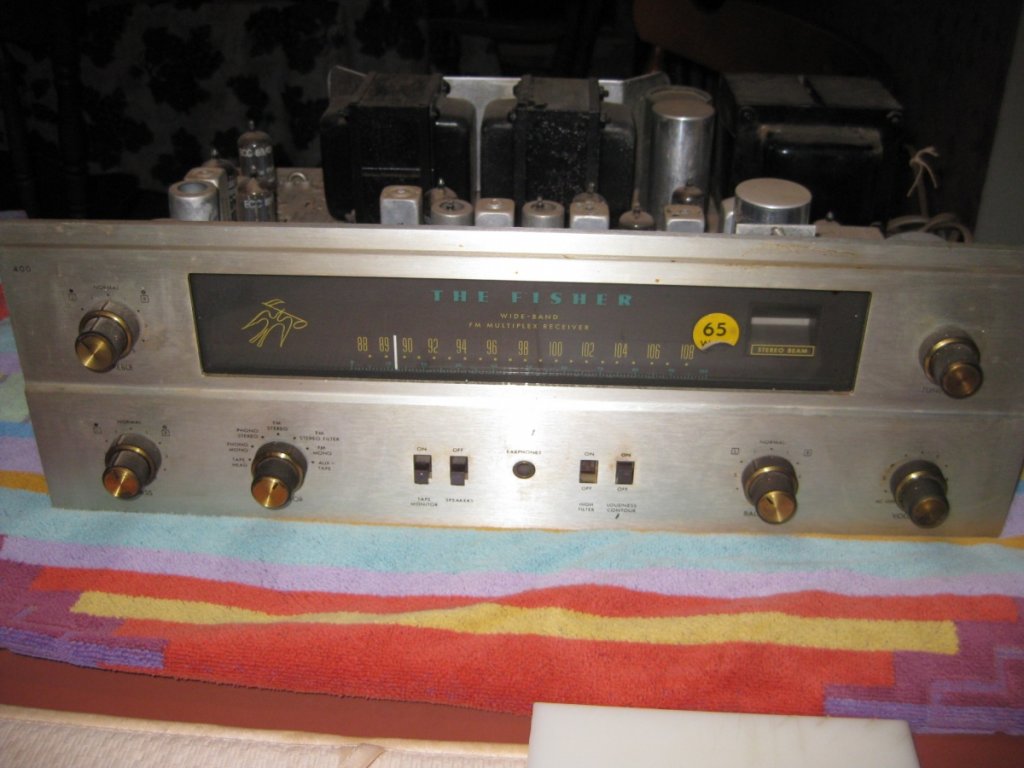

In a moment of weakness I took on another project- picked up a Fisher 400 receiver. Basically, it was cheap, full of Telefunken tubes, and I thought what the heck...  But the 7868 power tubes are a variation I'm not familiar with.  Is this something that is worth spending time/money on?

Well, it's all there plus the walnut case for $100.  My friend with a record store had taken it in so long ago, he had forgotten that it was hidden deep in the stacks of his back room.  I saw it about a month ago and commented that it was probably worth restoring.  I picked it up today. Lots of dust and cigarette smoke, but it's cleaning up nicely.  I'll test the tubes later this weekend, and if they are ok, I'll put it on a Variac and see if it will come to life.

Beautiful amp, they knew how to made a tube amp in the old days.
I dont know the strong points from the 7868 but its a 9 pin Pentode, plate dissipation is low 19W (EL34 is 40W).
It may have a sweet sound in Triode, the low price is a positive thing.

I've decided to go ahead and do this old receiver right and restore it.  There are several guys offering kits for around $80.  Picked up a kit with sonicaps, orange drops, panny golds, misc resistors, silicon bridge, diodes, current limiter, schematics, Fisher repair manual, trouble shooting guide, and great color photos of before and after with parts circled and numbered.
Nice restorations kit for those of us that know just enough to get into trouble.
As I go, I'll take pics and post.
