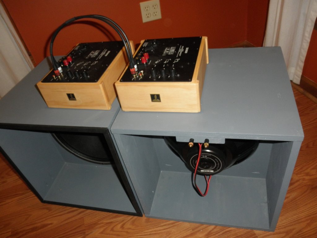

Poultrygeist
I've enjoyed these workhorse H-frame Alphas for a number of years now. The fact that you can try a variety of different drivers on top makes them very flexible.
undertowogt1
Those subs look sweet Poultrygeist. Nice work
