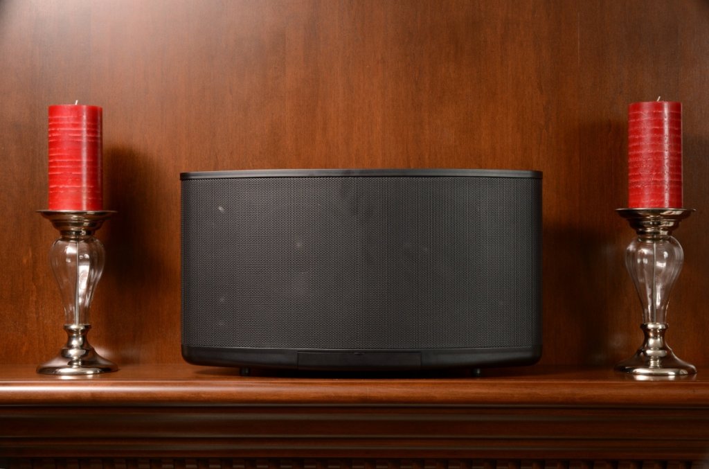

Some shots of my unit at home.
james
Marius
Re: BryFi
« Reply #46 on: 11 May 2016, 04:01 pm »
Cool James,
Looks much better than the other day! Cant wait to test it really, exactly what I've been wanting.

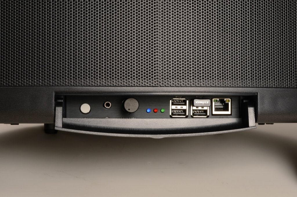

Please don't tell me the LAN port is on the front panel.... ?

Re: BryFi
« Reply #47 on: 11 May 2016, 04:13 pm »
Yes it is behind the door on the front panel but I assume most will use it wirelessly. You can also run the Ethernet cable undernieth the unit and connected it so it's hidden if you want.
James

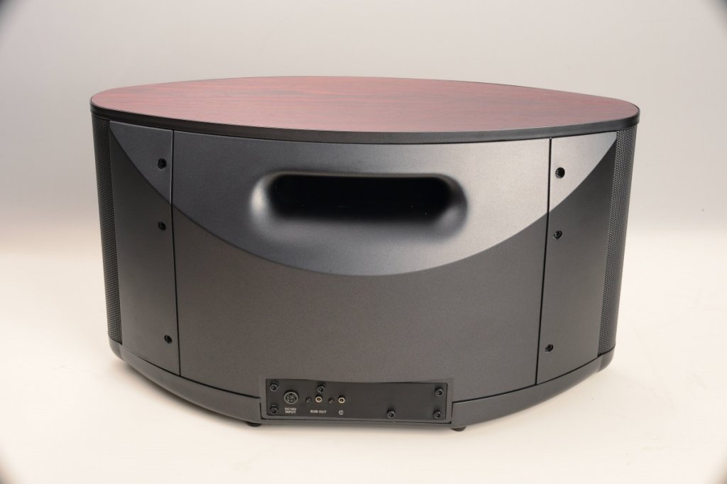

« Reply #48 on: 11 May 2016, 04:25 pm »
Is that a rear port or a handle? (both?)

« Reply #49 on: 11 May 2016, 04:45 pm »
Hi
Both :thumb:

« Reply #50 on: 11 May 2016, 06:03 pm »
James
underneath? is there a second Lan port? or do you mean underneath to the front, and with the lid open?
it should really be on the back James, room enough to judge by the image.

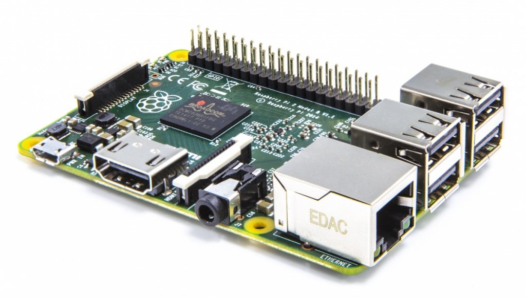

Hi
It can not be on the back as it is part of the Raspberry Pi circuit board

Grit
  • Posts: 693
  • - Garrett
Re: BryFi
« Reply #53 on: 11 May 2016, 09:05 pm »
Yeah, I don't see the value of the ethernet port in the front either.

unincognito
  • Posts: 2067
    • bryston.com
Re: BryFi
« Reply #55 on: 11 May 2016, 10:43 pm »
There really wasn't much of a choice it was that or both the ethernet and usb ports end up on the back, whats more of an inconvenience ethernet on the front or usb ports on the back?

Re: BryFi
« Reply #58 on: 12 May 2016, 05:44 am »
HI Chris, James,
Honestly, i am a bit baffled by your philosophy.
There's plenty of extras to be clicked on the Raspberry board. If  an extra ethernet port wasn't an option, maybe you could have made an extra set of usb ports, just like on the BDP, and flip the board. Bryston has a complete opposite position on the BDP1/2, developing from 2 to 4 usb ports on the back, next to the Lan.
There really shouldn't be an either this or that with these kind of premium products.
How come you let the design specifics of a small board of about 35 $, set the design principles of a new premium Bryston product. Which probably won't be priced south of 1000$.
Beach- and party-users might not need the Lan, moving around, but office and living room users might very well do. I for one belong to the latter, always preferring a wired connection, especially playing the hires files i would you this product for over the home network.
Well, i guess this isn't a prototype anymore... all in all it seems a wonderful product, wishing you the best of succes with it.
Marius

Re: BryFi
« Reply #59 on: 12 May 2016, 12:28 pm »
HI Chris, James,
Marius
Sorry but the Pi board doesn't work that way, it's Broadcom chip has one USB bus that is attached to a four port USB hub/100mb Ethernet adapter ic and the io is already mounted to the board.  There isn't an spi or i2c bus fast enough on its GPIO for anything else.
