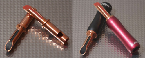

You're right, I haven't used the Furutech banana plugs but I thought there might be an alternative to the OP's dilemma described as "a hollow character to the sound".  What I don't like about the design of that particular plug is the setscrew to bare wire termination and I really much prefer a good crimp or crimp & solder.
I did come across some interesting plugs that I've not tried yet, the Furez TST-W/WP series tensioned split tube banana plugs. Unlike the LS4 which does use a hardened copper alloy to achieve spring tension, the Furez plugs are soft copper with an elastomeric insert that provides tension, according to the manufacturer, nearly rivaling locking banana plugs.
However, beyond the tension, the split tube design allows the plug to conform to the inner surface of the binding post for its entire length.  The W series requires heat shrink to cover the termination and the WP series has a small diameter profile aluminum shell.
They are available in bare copper or silver-plated copper and range from ~ $19/pair to $34/pair.
