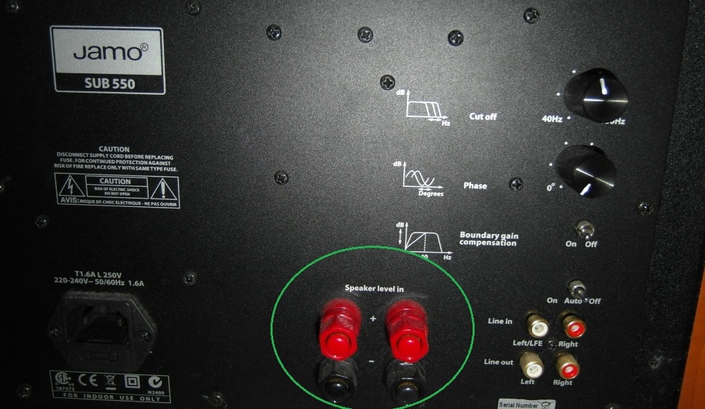

BTW, i think i found myself a SUB, the JAMO Sub-550. The Sub has speaker level inputs.
So i think im just gonna leave my current two speakers connected to my amp. Since i have to connect the SUB to the AMP for the audiosignal, im just gonna do that.

No, you connect the amp to the sub, then the sub to the speakers.  I'm pretty sure the Jamo has an internal crossover that splits the low frequencies to the sub, then sends the higher frequency signal to the speakers.
No, the Jamo SUB 550 only has L+R speaker level Inputs, there are no speaker Output connections.

Your right Steve, I was looking at another model and assumed.  The op should buy a different sub then.  You know, one that hooks up the way I say it should. :lol:  Seriously though, isn't running two sets of wires from the receiver to the speakers and the sub a parallel connection, lowering the impedance by half, and possibly risking damage to speaker and amp?

No, speaker level inputs have a very high input impedance so your amp only "sees" the main speaker impedance.

That's true.  For some reason REL subs (who strongly recommend speaker level inputs vs. line level inputs) feel you need a super high input impedance (100K ohms) to have zero effect on the mains.  But really, even with the Jamo SUB 550's input impedance at a "lowly" 22K ohms in parallel with an 8 ohm main speaker load, the total parallel resistance is 7.997 ohms (and 3.999 ohms with 4 ohm main speakers)!
As far as high passing the mains, my own experience has been that if you can play your mains full range at the volume you want without undue distortion or strain, then you shouldn't really high-pass them.  The low E of a 5 string bass guitar has a fundamental of 40Hz, so not messing with another crossover in that region if you don't have to makes sense.
So normally if that's the case, I'll run the mains full range and add just a little somethin' extra somewhere around 60Hz or below.

Wait... so is the JAMO 550 gonna work now or not?
I do not want to connect my speakers to the JAMO, they gonna be connected to the AMP, im fine as they are.
I thought i just had to connect the AMP to the JAMO via those INPUT connections and i get audio signal to it.
Yes, it will work.  Main speakers and subwoofer will both connect to speaker outputs of amplifier.
It usually takes a bit of trial and error to find the best settings for input level (volume), crossover frequency and phase control.  You will also get varying bass response with the location of the sub.  If you have the flexibility to try it in different locations, do so.  The corners of the room are usually the worst location.
