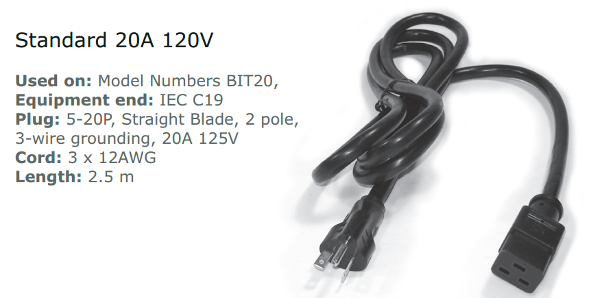

And the 20 amp unit does not need an adapter cable as the 20 amp unit has a standard plug without the dogleg 20 amp-only feature. Easily seen in the owners manual on-line.
I have the Torus RM20 and used it at AXPONA. Easily tripped it with our setup. We added another 20 amp circuit for the amps. Still tripped the circuits. Finally had to go with three 20 amp circuits to have enough power. Speakers used are 95 dB efficient at 30 Hz, but over 100 dB/1 watt from 50 Hz and up.  :)
The 20 amp unit does need an adapter cable or plug if using a 15 amp outlet. Picture is from the BIT20 manual and matches my cord and RM20 manual:
Menards carrys adapters.
