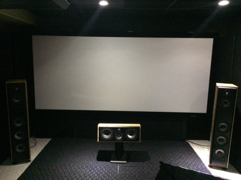

jarcher
  • Posts: 1940
  • It Just Sounds Right
Re: Successful HT room in a basement 7' ceilings?
« Reply #6 on: 1 Apr 2016, 04:49 am »
My basement is in an older house as well with perhaps under 8 ft ceiling. I have a 96 screen which works great. The top of the screen frame almost touches the ceiling drywall but I still have room for the center channel below and subs. I like having my screen lower - don't like craning my neck up. Guess I'm more of a mid to back row viewer than front row. Should be some photos of my set up in my profile.
The projector is low and I've placed it on purpose above the seats in a way that people are not going to knock in to it. I suppose if your room is not to long you can also mount it on the back wall. I like it closer / center of room so people don't block the image walking in front of it. It also allows means I don't have to run the projector brightness flat out. Not a problem with cheaper epsons which are light cannons, but JVCs don't tend to run as bright.

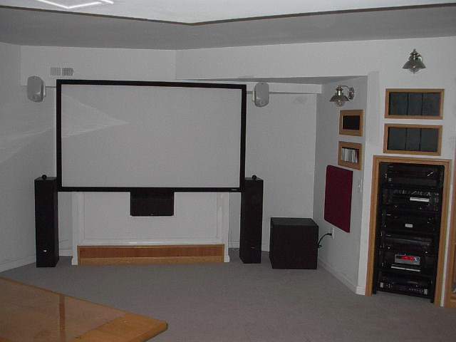

Phil A
« Reply #11 on: 1 Apr 2016, 02:31 pm »
The basement in my old house probably had a ceiling a few inches under 8 feet and was fine.  I built a shelf in front of a soffit for the projector.
Phil A
« Reply #12 on: 1 Apr 2016, 02:36 pm »
PS - the little trap door (which was just moulding around a piece of sheet rock) in the above pic (near the top) was so I could get to the wiring in back of the projector (I cut a hole in the soffit).  I ran (a couple of 2 inch pieces of) PVC in the ceiling from the unfinished part of the basement above the equipment rack so I could slide video cabling and a  power cord.  The projector covered the opening in back and I put an air conditioning vent cover in the ceiling not connected to anything above the projector so that any hot air had additional space to go besides the several inches between the top of the projector and the ceiling.
