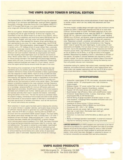

Hmm, actually, this isn't the speaker that I'm asking about.  The ones I am asking about were probably older.
Here is a picture for reference:

Re: Super Tower /R SE specs
« Reply #6 on: 19 Mar 2016, 02:53 am »
maybe this one. Zak

1996 Stereo Review Buyer's Guide:
Super Tower/R Special Edition
Two 15" and one 10" woven-carbon woofers, two 5" woven-carbon cone midranges, two 1" Focal dome tweeters, and one 2" ribbon supertweeter. Bi-wire/biamp terminals. 100lb.
No other specs.
Edit
1996 Audio magazine's Equipment Directory
20-50k +0 -3; 94 dB; x-o 80, 600, 5k, 15k; 4 ohms; 18" x 18" x 52"; 175lbs; $3400/pair

Thanks, but what a tease!  However, it looks like the newer versions just replaced the mids with ribbons, so the specs were probably the same.

The difference in sensitivity (90dB vs 94dB) is most likely 1w/1m vs 2.83v/1m, which is 2 watts into 4 ohms; 94-3dB = 91dB
