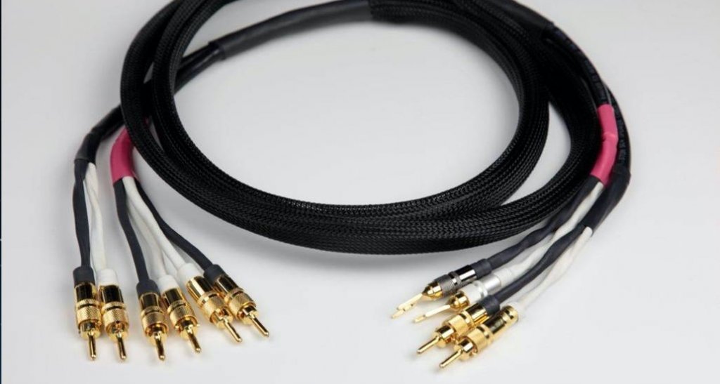

Hi
Here is the info on the speaker cables:
BRYSTON SPEAKER CABLES
Gauge: - 9.5
Resistance - .003 Ohms Per Meter
Capacitance – 97 P/F Per Meter
Inductance - .4 MicroHenry Per Meter
I will see if I can find the info on the interconnects - the single ended is Canare and the Balanced is low noise microphone cable from VanDamme.
james
