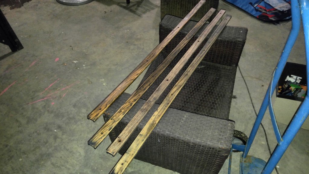

dman535
  • Posts: 6
Re: Refinish Side Rails
« Reply #5 on: 17 Mar 2016, 01:52 pm »

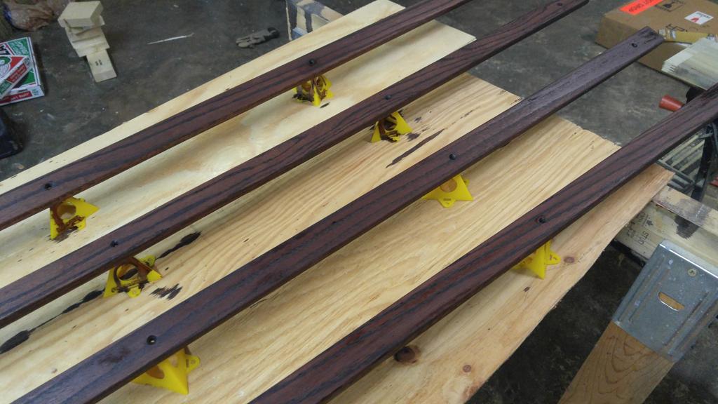

The rails are off and stripped. Will start sanding today. Found a Bombay Mahogany stain that I think will work but don't want them to turn out to red.
dman535
  • Posts: 6
« Reply #6 on: 19 Mar 2016, 01:20 pm »
Firt application of color went fine, just hate the color. Looks like more sanding and another try.

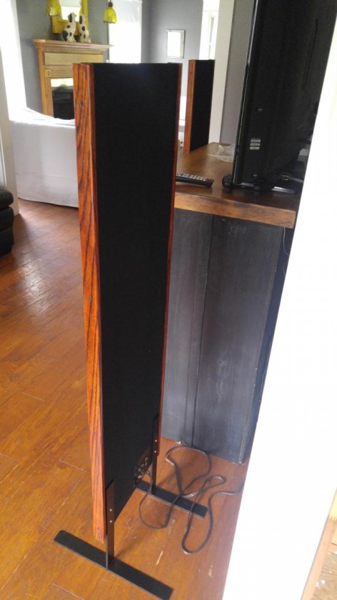

dman535
  • Posts: 6
« Reply #7 on: 24 Mar 2016, 02:35 pm »

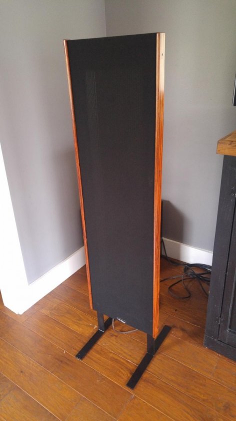

All Done !
mcgsxr
« Reply #8 on: 24 Mar 2016, 02:39 pm »
Very nice result.  Always fun to customize a piece to your own satisfaction.  Nice stands too.

dman535
  • Posts: 6
« Reply #9 on: 24 Mar 2016, 03:07 pm »
Thank you. Had some metal stands made up like my factory MGIII ones. Gets the speakers vertical and more toddler stable.
SteveFord
  • Posts: 6538
« Reply #10 on: 25 Mar 2016, 12:04 am »
Those turned out perfect.
