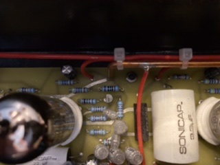

Luckily I saved all my email conversations with Gary and I found that he sent me 100Ohm resistors to make my original MC cart work.  There are 2 resistor standoffs where you can change between based on cart type.    So my question now is do I need 47k resistors to make the MM work?   Also 0.5 watt or 1.0?
Resistor top middle

47k resistors did the trick!!!
