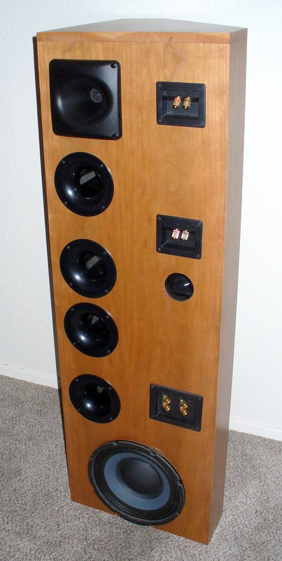

Here's another photo Duke took.
More photos, possibly including what's on the back side, when the weather breaks :)

Duke or Brian, what are the dimensions of the mains?  I assume they're sealed?
Thanks!
The mains are 45 inches tall.  Their footprint looks like we started with a 15" square, and then lopped off one corner to created a 45 degree beveled surface (the front baffle) that is about 15 inches across.   So measuring "tip to tip" across the widest dimension we get a little over 21 inches, and measuring bafflecenter-to-opposite-point the depth is a little under 14 inches.   When set up with 45 degrees of toe-in, such that the axes criss-cross in front of the listening area for widest sweet spot and minimal early sidewall reflections, the width is 15 inches and the depth is 15 inches.
The 12" mid woofers are in separate internal chambers of different internal volumes (so that their resonances do not coincide), each with two pluggable ports, giving each chamber three different tuning options (both ports open, one port open, sealed box) to tailor the midbass region to different room acoustic situations.   There is no reason why you can't run one chamber ported and the other sealed, nor any reason why you can't tune the left speaker different from the right speaker if their room acoustic situations are significantly different.  Like if the left speaker is in a corner and the right speaker has no side wall, you might seal all the ports on the left and open some or even all on the right.
The size of the midwoofer was chosen for radiation pattern control, but one side-effect is that the mains can be used without a protective high-pass filter at fairly high SPLs, like 116 dB vented and 124 dB sealed.  So you would have the option of not adding a high-pass filter to the mains' signal path.

Duke just sent this photo of the rear of the Bienville.
Tweeter up high, woofer down low, two pluggable ports for front firing drivers, two for the rear drivers. The two pairs of binding posts up high are for the load resistors for the front and rear tweeters. A level control for the rear drivers below that. Twin pairs of binding posts down low for the front and rear drivers.

...two pluggable ports for front firing drivers, two for the rear drivers.
Sorry I wasn't clear Brian... the pluggable ports are all for the front-firing woofers, which are each in their own separate chambers of different sizs to stagger the resonances and provide more tuning flexibility.  The rear-firing woofer is in its own separate sealed chamber.
The front-firing array is a 16 ohm load, and the rear-firing array is likewise a 16 ohm load.  So driving both arrays in parallel, we have an 8 ohm load.
The level control on the rear-firing array improves the adjustability for room acoustics and speaker placement.

The dual bass loading system is interesting: reflex-loaded front-firing dual mid-bass, sealed rear-firing single mid-bass.
Years ago I built a similar array: sealed 10" mid bass above reflex-loaded 15" bass, both front-firing (reflex-loading was via side-firing 15" passive radiator mounted inches above the floor).  It performed very well.  I'm surprised this approach is not more common.
I suspect exceptional results, especially considering Bienville Suite splits the mid-bass above 70 Hz among three drivers.
Do the rear drivers comprise a "Vertical Offset Bipolar" Array?  Duke assigned this name to his 2008 TAS Golden Ear Award Winning original Dream Maker.  In this case "Vertical Offset" refers to the disparity in the height of the front and rear mid bass drivers.
