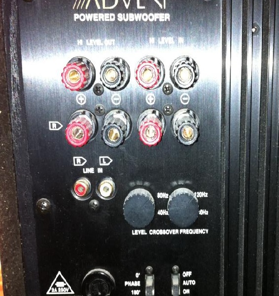

I'm using an old-school subwoofer (Advent from '96) and passive pre-amp (Mod Squad Line Drive). I had it hooked up high level which seemed to work fine, but wanted to hook it up low level line in with RCAs. The subwoofer has no volume control -- only two continuously variable crossover controls (marked 40-80 and 120-180). I found when I hooked it up low level that the subwoofer output was almost nonexistent. It seemed like it needed a volume control, but doesn't have one. I assume this due to the passive pre-amp. Is there any fix other than a non-passive pre-amp or going back to high level?

Having two crossover frequency controls doesn't make a whole lot of sense.
If this is the subwoofer - the control on the left is Level (volume) and the one on the right is Crossover Frequency (with markings at 40Hz, 80Hz, 120Hz, 180Hz).
If that's not the case, and you truly have no level/volume control (or it's non-functioning), the the passive preamp is certainly part of the problem with very low output.

Thanks for the reply, Steve. Wow -- that was pretty dumb of me to not look more closely. Of course you are correct -- it does have a volume and single variable crossover.
Regardless, it sounds like low level with a passive pre-amp (at least this one) just isn't going to work. I picked up this subwoofer to try out using a subwoofer and I do like it (adding a subwoofer to fill in the low octaves with bookshelves) and now want to consider investing in a nice, musical subwoofer. I guess my options are get an active pre-amp or use the high level inputs. I suppose if I had a higher quality sub I wouldn't be as concerned with some loss of quality by using the high level inputs.
