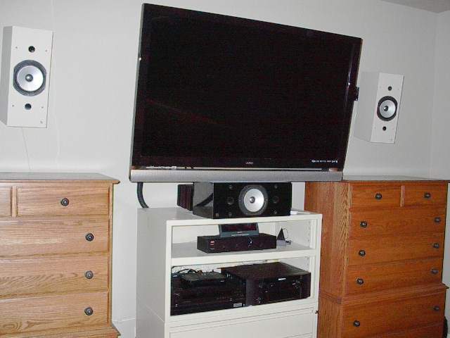

« Reply #8 on: 24 Feb 2016, 12:47 am »
I've had so many set-ups as well.  Below is a pic of the bedroom system in the old house where I had 3 identical speakers (Thiel SCS2s, which I now use one pair as side surrounds and one as back surrounds in the current main system).  Sometimes it is not practical to have the 3 identical speakers (not that my set-up was practical as many would make a comment about the 55 inch TV hanging of the wall and the big bookshelf speakers hanging on the wall too - I guess it made its way into my head as I have a 32 inch TV in the bedroom now which is rarely used but have a projector with a 92 inch screen that folds into the ceiling and all in-ceiling speakers so it looks more civil).
