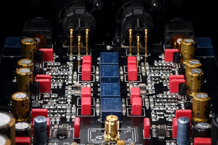

Sorry, no.  The output stage of the Gustard has three stages in series.  The first stage is single surface mount I-V converter op amps for each phase (AD4898-1).  Excellent sound.  You will not do better in an op amp.  Second stage is OPA 1632 differential amplifier (also an op amp).  Third stage is discrete buffer.  Changing the op amps for I-V conversion would be a waste of time.  Been there.  What you need is a fully discrete output stage....my first try will be tomorrow.  This output stage will also have its own separate regulators and power supply parts separate from those powering the stock output stage.  Hopefully, we get better sound.  The stock output stage is REALLY GREAT!
You can see two of the IV converter op amps in the fore ground in the above pic and straight back and in between the middle two red Wima caps you can see an even tinier 1632 on each channel.
Hi Ric. i have another Chincese DAC with the picture attached bellow, do you think i can the an opamp upgrade on it? I mean I know it is just a direct replacement. i want to know what to replace it with. what is the best option?

There is a thread on Headfi on that DAC.  One guy replaced the first op amps with Sonic Imagery 994 discrete op amps (a little over $200 the pair with shipping) and the second opamps with latest Burson V5 jobbies ($130 pair plus shipping).  He did a bunch of other tweaks as well.  Have fun!

what are those variable reisstors? i assume they set bias. would teaking them be advisable and if so how would i go about doing that. i do own a multimeter but i have no idea what to to go about it.

Please read the Headfi thread.  They talk about the variable resistors and changing them to expensive Vishays.
