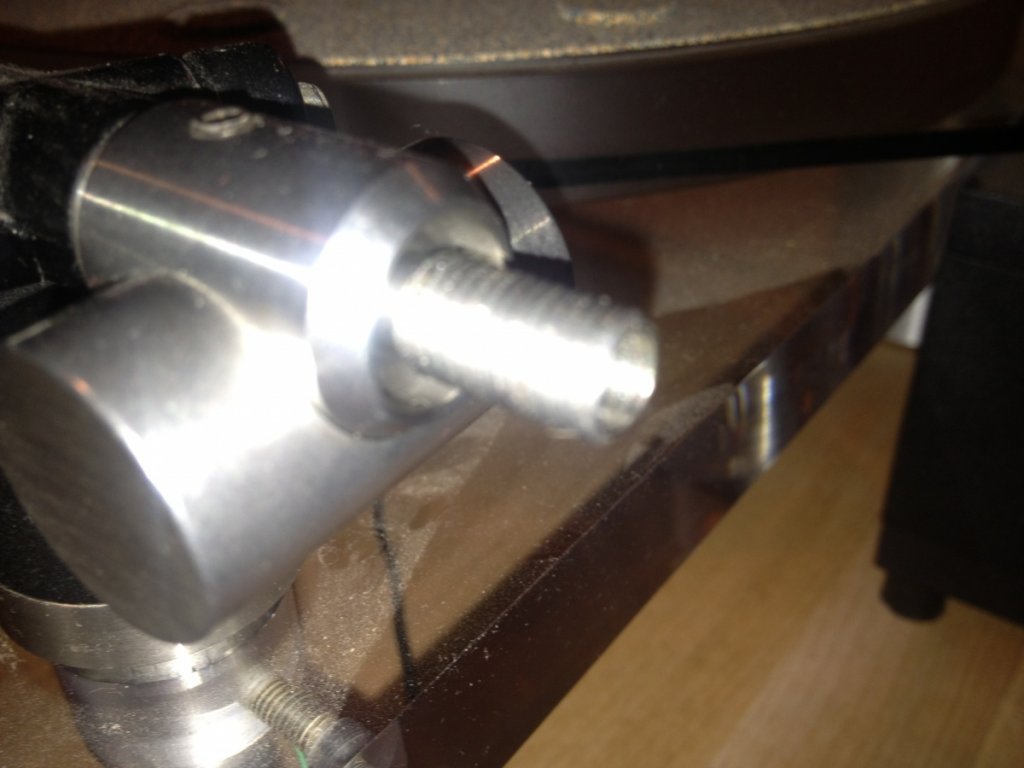

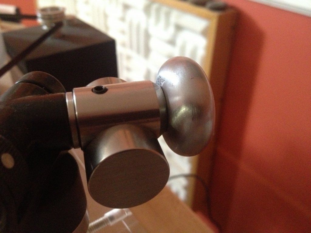

Looking for the thread size and pitch for the adjustment knob on the back of a JA Michell counter weight assembly. I have tried the following thread sizes with no luck...
5/16-18
5/16-24
M8-1.0
M8-1.25
I have searched for drawings or illustrations with dimensions as well. Nothing. If anyone has the facts, please let me know.

Did that before starting the thread. It seems to be some bastard size pitch. It is an adjustment knob, so fine pitch is almost understood, but it doesn't fit industry standards.

I did get a reply from Steve Rowland at J A Michell Engineering. Although he did not specify a thread size and pitch, he did recall the thread was a double-start. And that it is not recommended to hang weight on the extreme end of the arm. He also suggested buying an extra-heavy weight from their US distributor. For now, I just bored a slightly larger hole in my weight. Not perfect but it will get me the correct weight needed for an aluminum body, Denon cartridge.
