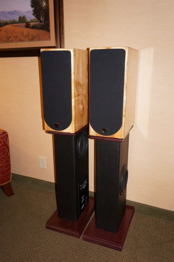

Steven,
My Wedge shaped cabinets for use with 12" drivers are 6"W at the front, 12"W in the rear, 17-1/4" deep and 28" tall. You can change the dimensions to fit your needs. If you want to place and N3S on top you would want the front to be at least 8-1/2" wide to match the N3S. If you left the depth at 17-1/4" that would make the width across the back about 14-1/2".
However, the wedge cabinet is an open baffle design and may not be the best match for the N3S, which is a sealed box, depending on what you are looking for. Being a sealed box the N3S can be placed very close to the front wall while the wedge cabinet has to be at least 3 feet from the front wall since it is open baffle.
The Best Speaker Stand Ever might be a better fit for the N3S. Here is a picture of these stands with X-CS Encores.
These stands were built with two 8" drivers each and the amps are built into the stands.
Another possible downside to the OB wedge base would come into play if you planned on using them with home theater as well as music. This is because you cannot connect the LFE channel (subwoofer out) from an AVR to OB subs. The extremely low frequencies of the sound effects, especially in action movies, will overdrive the subs. OB subs are designed for music, not home theater. You can use OB subs in a home theater setup if you have the OB subs connected to the main front channels and a sealed or ported sub(s) designed for home theater connected to the LFE channel.  You would set the main speakers to Large/Full Range and the subwoofer to LFE only. This way the HT sub(s) will not be playing for music and will only produce sound when there is some type of special effect encoded on the LFE (.1) channel.
Mike
