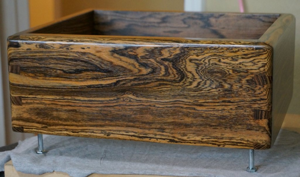

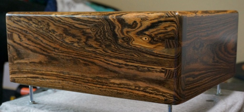

Ed,
Building amp boxes out of hard wood opens up a lot of possibilities. Here is a pair I'm building for A370PEQ amps out of Bocote. Joinery is through dovetail with a 3/8" roundover on the top edges and corners. They currently have two coats of finish. There will be at least three maybe four coats when completed.
Mike

« Reply #25 on: 10 Apr 2016, 11:30 pm »
Beautiful.
What are you doing for feet? Do feet make much of a difference with the A370's?

« Reply #26 on: 10 Apr 2016, 11:33 pm »
Those are gorgeous Mike, beautiful work.

« Reply #27 on: 10 Apr 2016, 11:39 pm »
wow,  those are   gorgeous  Mike   :thumb:
