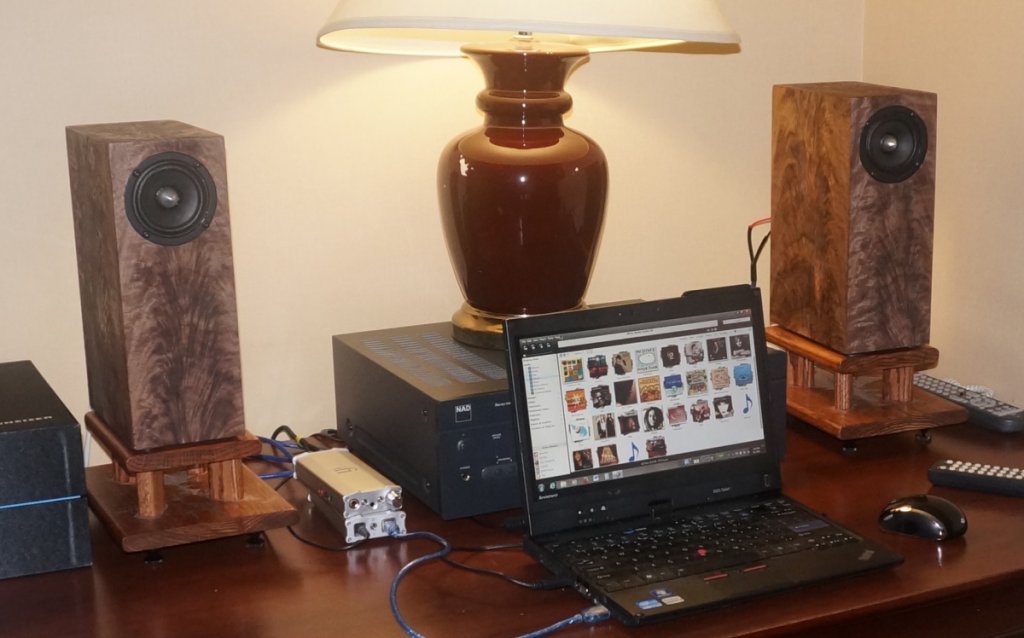

I have built a number of the X series Encore kits for myself and others.  These are fantastic speakers at shockingly low prices. And like everything DIY, the more you do for yourself the less the total cost.
There is also the LGK 1.0 desktop monitor. At $189 these little jewels are unmatched for the desktop and even do very well in small rooms. Here's a review of them by Ron at New Record Day

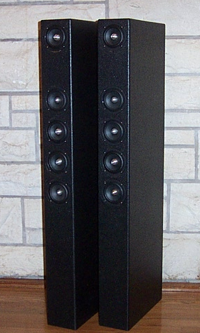

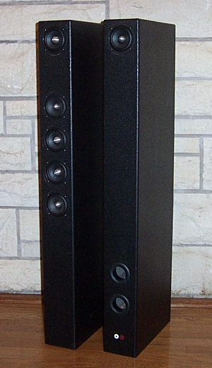

if a small form factor is what you are looking for, you can't beat the LGK series of speakers. While the desktop 1.0's are the only ones listed on the website, the floor standing Skinny 6 is also available.  Here's the 1.0
Here's the Skinny 6.  They look huge in the picture but they aren't. They are only 4-1/2" wide x 41" tall x 13" deep
