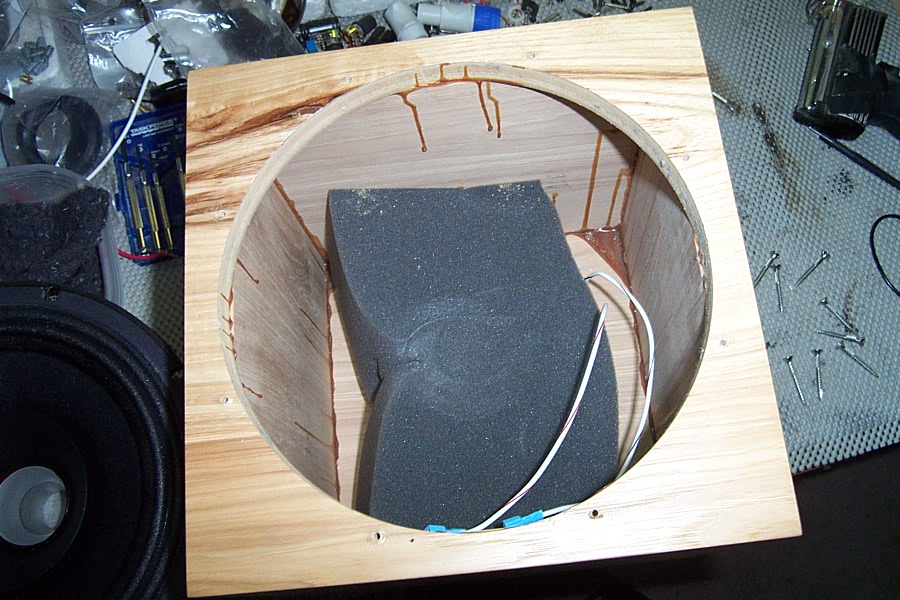

I knew I would have to coat the boxes with Dura Tec and took two different mismatched speaker cabinets knowing this, and would put my time in to adding a xo to smooth things out.  When I first got these speakers I let them break in for some time and noticed a lack of low-mid bass and the highs where even to much for me.  Looking at the freq plot supplied by the company and professional reviewers I noticed the real high end peak and a drop out towards the top (later was told that was due to the throat of the coaxial).  It is a nice sounding speaker for some, so I dropped it off to Danny and told him to go nuts.  I kept one in original form to do a side by side comparison in the end.
We started with the following parts.  Pictures are self explanatory.
The inside of the box was like what you see above, the wire was attached with clips and not soldered, and the speaker inputs were jammed in and included no nut on the side to keep them from being pulled out.
After the xo was put together by Danny, this is what was the outcome.  It is much smoother and from the various waterfall graphs you can see the cleaner response etc.  (Danny feel free to add the tech stuff here.)  I lined the boxes with No Rez all around and build the p2p XO on a separate sheet of 1/8 inch board and set it in the bottom of the box.  There was a set of GR speaker connectors added and the entire box was covered in Dura Tec with a 3/8 inch nap roller.  I added three coats to make sure it was even.  I love this stuff because it is so easy to NOT screw up..

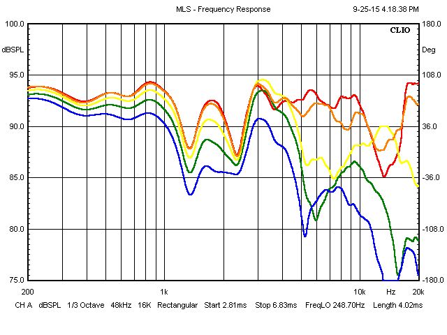

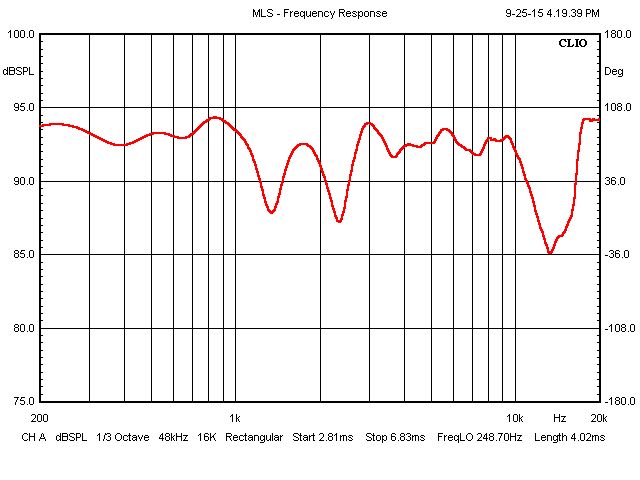

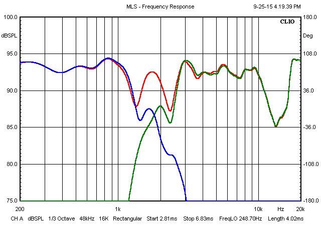

Look at the response curve that John posted. It matches this one taken by Sound and Vision.
The dipped area at 4kHz is due to the woofer and the tweeter both covering that range but being out a phase. By being out of phase they cancel each other out and cause a hole. That is a problem that is easily fixed. It is not a subjective issue. There is not supposed to be a hole there. There is no preference in making a hole there.
Now the hole in the response that is centered at 15kHz is from throat cancellation in the tweeter. To fix that requires reshaping the throat and maybe adding a damping ring to absorb a little at a given frequency to do away with a cancellation effect there. I can't fix that. It is driver related.

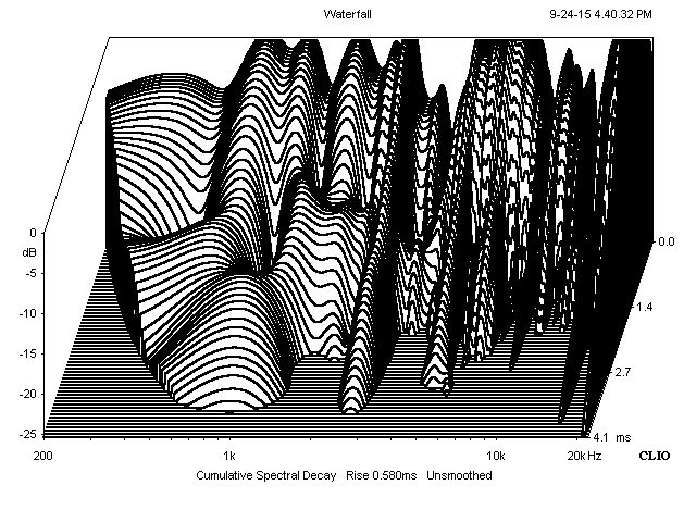

Now look at the spectral decay. There is a ton of stored energy there. It is heard as an excessive ringing and smearing. It is not subjective or about preference. It is a problem. Some of this problem can be fixed. The ringing in the upper ranges is from woofer break up. This can be controlled by a proper crossover. The long decay rates in the lower region that look like they pop up from an area that was already down is the result of internal cabinet reflections. This colors and smears the sound considerably and is very easy to hear. Again this is not about preference. It is a problem. The cabinets were not properly damped. A small block of foam doesn't work. It might be economical from a production stand point, but it doesn't cut it. Lining the cabinet with No Rez and using a little additional damping solved this problem. See the latter much cleaner spectral decay.
There was also no baffle step loss compensation as there was no filter on the woofer at all. So the response fell off quickly below 700Hz or so (500Hz on the Sound and Vision measurements). This is not a matter of preference or taste. It is unnaturally low in output because there is no compensation for it. The new network that I designed did compensate for it and produced a smoother and more balanced response. It is not a subjective matter. Mid-range and bass areas are not supposed to be rolled off.
Thin un-braced cabinet walls resonate. It colors the sound. It isn't about subjective preference. It is not part of the input signal. Lining it with No Rez killed the resonances of the cabinet panels and took away that coloration.

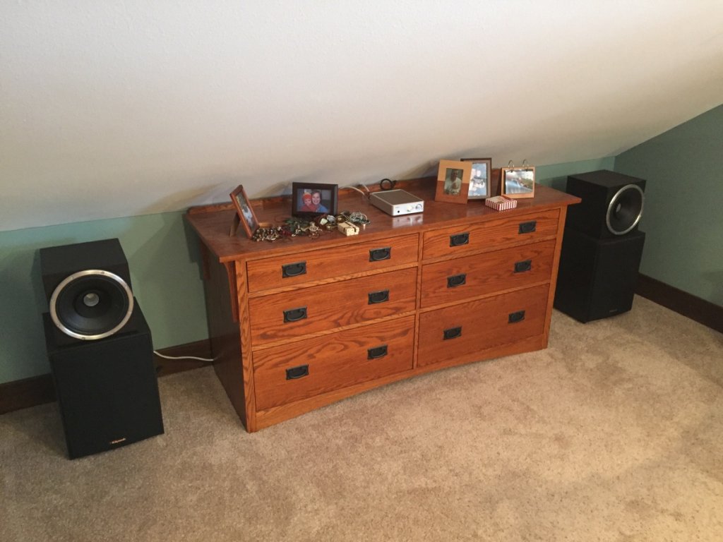

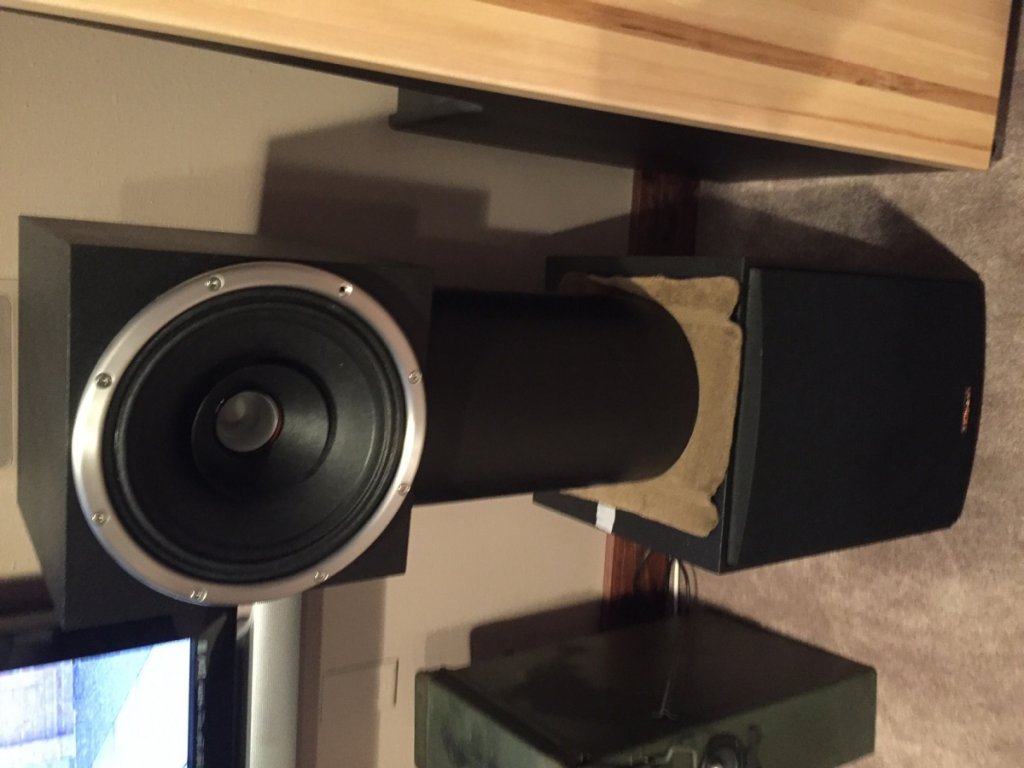

With regards to sound and experiences, here is what I have encountered.
Prior to the XO being installed there was some noticeable break up of the sound in the higher midrange and then moving in to the tweeter freq. area.  I find this also on other full range drivers when you try to drive them to higher levels of output.  With the XO installed, this has gone away, with the only item I notice is the high freq is somewhat muted in the range, possibly due to the physical throat the tweeter has to play through.  I have a preference for the NEO 3 and its smooth range ability and second would be the T26SG Tweeter I have had lots of time with.  If you could use the LGK driver just on the high end (which is being done another models) it is similar to the NEO 3 in my listening.
The response on and off axis of the Zu prior to the xo was very specific and narrow.  This has widened some, but as soon as you get off about 30 degrees you lose much of the high end information coming from the tweeter even with the XO.
Imaging is much better with the XO.  I can sit and place instruments easier and they have wider separation using Neil Young's Massy Hall recording and some songs from Nirvana's MTV unplugged album.  I use these examples for myself because I also have visual representation of where the actual instruments are being played from to help confirm what I am hearing.  By no means are these audiophile quality recordings but help in the process.
I knew these would need some lower end reinforcement and have paired them with some free Klipsch SW 8 subs.  I currently have build wedge shape stands to have them sit on the subs, but rake them back about 3-4  degrees-the stance is similar to a Klipsch Heresy speaker and will fit well in the final resting spot which is up against a wall with a hipped roof line coming down - thus the lower form factor works well.
Hope this helps.

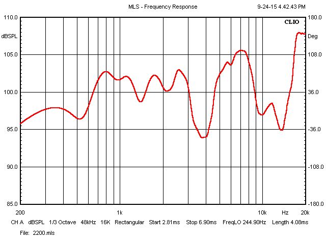

Here is the difference in the off axis John is referring to. This is also not a matter of subjective preference. This is about actual output levels in the off axis. This is the stock speaker:
The off axis falls off quickly because the upper regions are being covered by a 10" woofer. Have a good look at the Yellow line that is 20 degrees off axis and you'll see that it already has a very limited upper end output.
Now compare to the version using the crossover that I designed. The tweeter is now covering the upper ranges so the off axis response is much more balanced.
They will now load the room a little more evenly and offer a more balanced in room response.

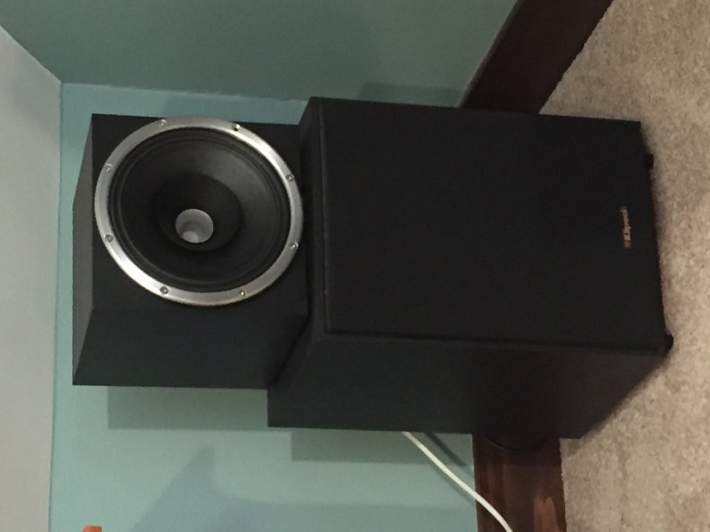

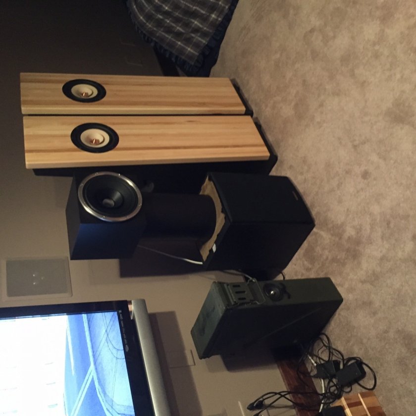

Final resting spot w/ PS Audio Sprout
« Reply #15 on: 22 Jan 2016, 09:49 pm »
Thank you Danny for the help with these.  Your Rush is in the mail

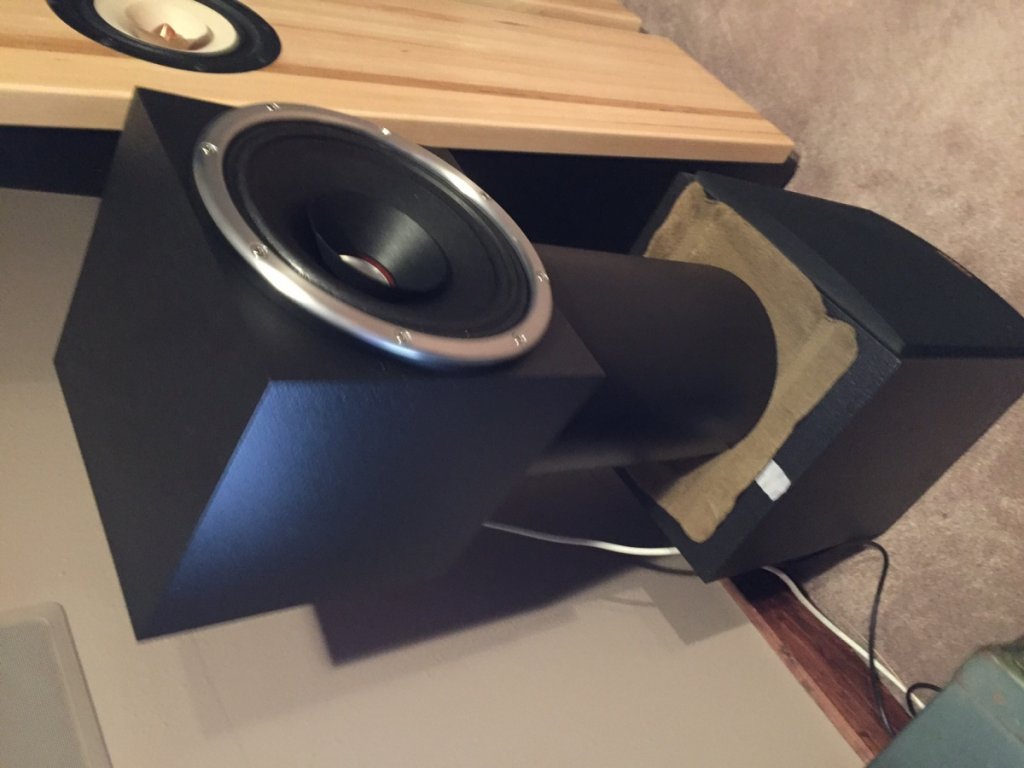

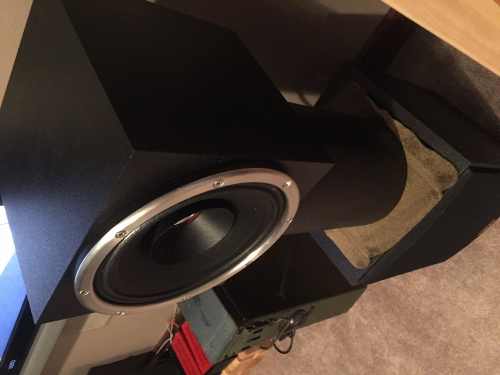

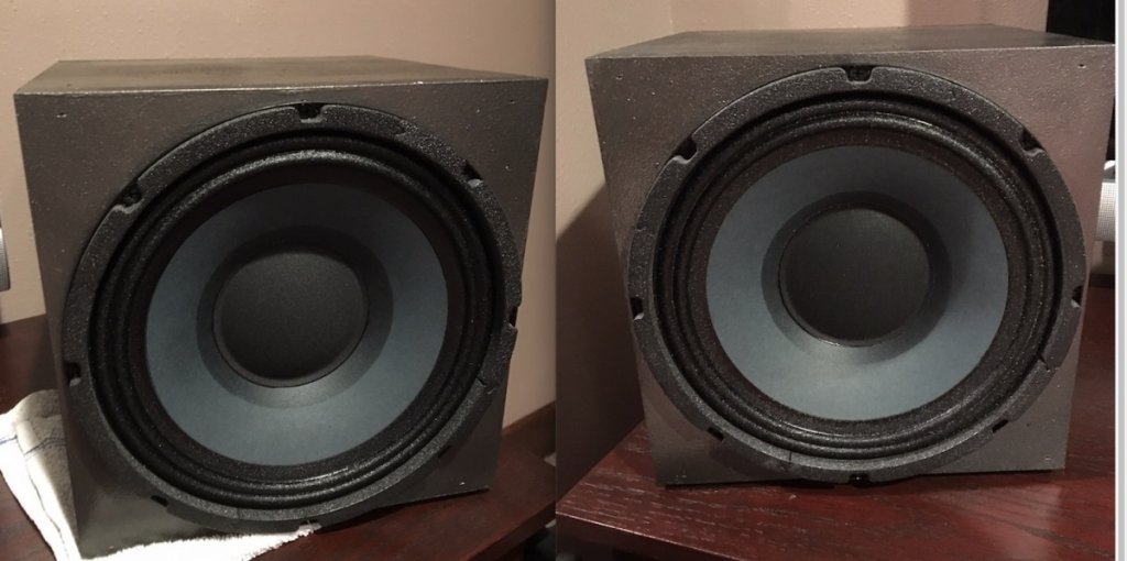

Taking the information Danny provided and what is on the inside of the box when opened up, I created a clone Zu Cube for my youngest son using the following from PE.  There is no wizzer cone on the driver, but the sound is significantly similar to the original Zu Cube.  The box is 1/2 left over material, 10.5 inches square, coated with dura tech, lined with No Rez remnants  and painted by the youngest.  I used solid core wire for hook up and the single inline cap for the tweeter.   When you compare the two speakers, one with and without xo, there has been no one that picked the speaker with the single cap in it as the best sounding.  They all gravitated to the speaker with the xo for multiple reasons, but many noted the top end sounded better.. Cost was 180, plus I had credit at PE, so 100 bucks for me and my parts.  I am not a fan of the blue tinted woofer... Not sure why it is not black....
Eminence Beta-10CX 10" Coaxial Driver
Eminence ASD1001 1" HF Titanium Horn Driver 1-3/8"-18 TPI

jparkhur,
Although I will agree on a general basis that most of the time even a "Full range driver" design like this will benefit from a bit of finesse using a decent crossover fact is your not comparing a basic Eminence driver in this case.
Zu does blow their drivers apart and re-tune them in the first place to work more with the single cap protecting the tweeter only. From my understanding the newer versions of Zu drivers take it a few steps further, with their "Nano" fluids etc... on the cone controlling more of the anomalies.
This does not matter to explain what you are hearing, but the Zu design ultimately is not as simple as taking a stock full range un-tuned eminence driver from my understanding.

undertow
  • Posts: 945
Re: ZU Cubes with some love from GR Research
« Reply #19 on: 4 Oct 2016, 04:16 pm »
Well in your photos you can see the gray style cone from eminence, Zu does not use those 25 dollar versions. Again I am not defending it one way or the other, but its not just the "Same" is all I am saying. However, there is a company that does do exactly as you just did using those basic eminence coax drivers.... Also from Utah!
