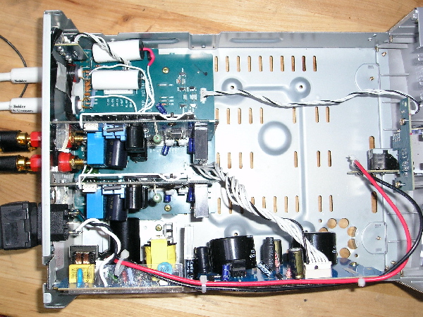

After a very long time, Mark's modded Teac is making music.
I changed out most of the capacitors in the power supplies. Changed out the input and output connectors. Hard wired the connectors right to the amp boards. Replaced the electrolytic coupling caps with Multicaps. Added an IEC connector. Did away with the input level controls and board.
I still intend to apply dampening material to most of the chassis and cover.
Right now, it is driving the 3 way Acoustic Reality 3Ds with sub module with no trouble.

Looks good to me... Glad to hear that is working out well, and looking forward to hearing it myself, eventually.

I am glad it finally make it to you safely, Mark.
The first shipping try destroyed the amp and I had to start all over.
I did change some of the mods and now have replaced just about all the critical parts in the power supply. I also replaced the power cables going to and from the power switch. The ferrite donut is back in place.
It will take about an month for Mark to get it broken in.
If he feels it to be worth it, I will start offering mods for the Teac after the first of the year.

Nice work Wayne, very cleanly done! I bet it sounds leagues better.
