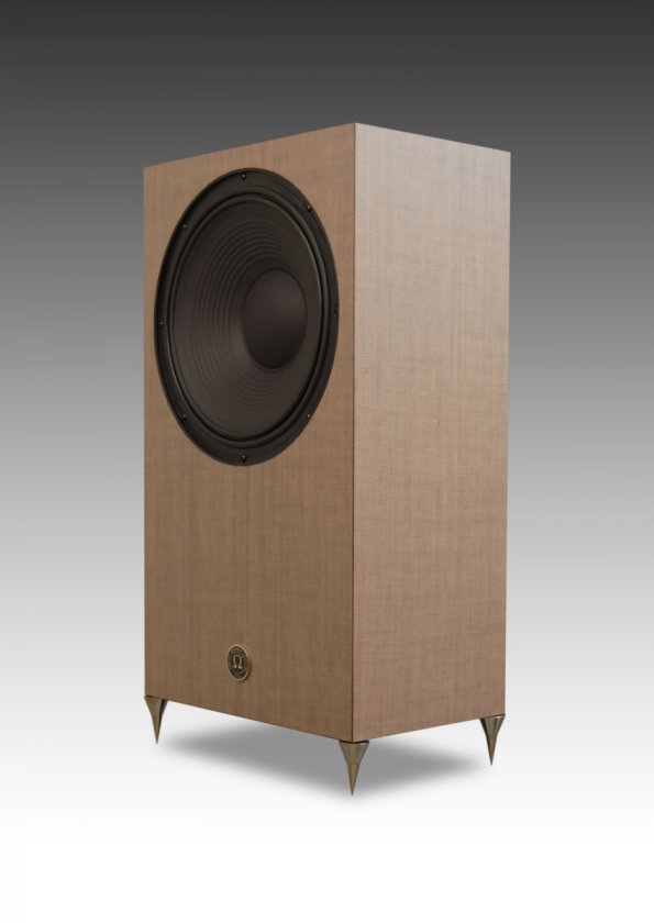

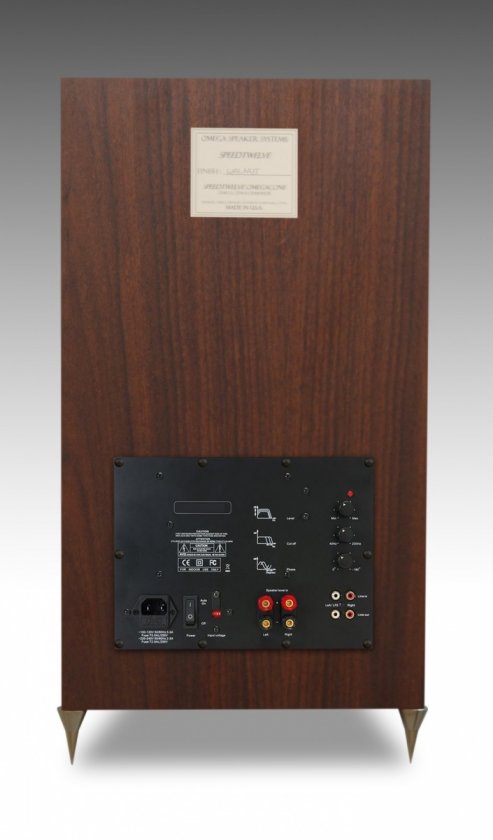

I will let the cat out of the bag.....in part at least.  Louis has a 12" front firing sub.  It's a departure from the standard subwoofer "look" with a very shallow (depthwise) cabinet.  My choice would be to put one smack in the middle on the floor between your speakers.  His new plate amp also has variable phase control so can be dialed in more precisely than a 0/180 switch.  Being this sub is sealed and has a flat cabinet, it would be so easy to put it between your speakers and have all drivers on the same plane.  I will try to get it up on the website hopefully today or tomorrow.

Here it is, the speedTWELVE :thumb:  http://omegaloudspeakers.com/speedtwelve.html

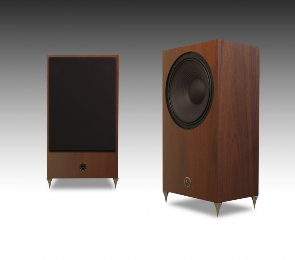

Can you explain the shape ? Almost every subwoofer I have ever seen is square. Thanks
roscoe65
  • Posts: 806
Re: Subwoofer for my Super Alnicos?
« Reply #19 on: 9 Dec 2015, 09:37 pm »
It is rectangular.
